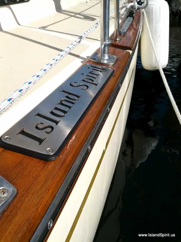

Custom Step Plates at the gate...
On December 24, 2013 after nearly two months of re-building, we connected the last wire and then installed the custom Island Spirit step plates, completing the refit of our 20 year old yacht. What a job. Back in May, we pulled into Snead Island Boat Works, in Palmetto, Fl, and took our boat apart. We hauled it out and truckled it to the Island Packet Yachts factory where she was built in 1993. From May to November, she was inside the factory and the skilled employees at IPY rebuilt systems back to new conditions. Then on November 4, we trucked the boat back to Snead Island Boat Works where we re-launched and then began the re-assembly of all systems we removed for trucking. I must say that the rebuilding of systems took far more effort then the tearing down of those systems. It actually took us nearly two months to rebuild, but only about 2 weeks to tear it all down.
