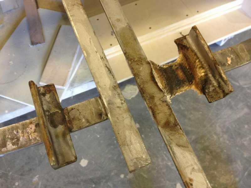

12 years 10 months ago #2280 by hayden
Replied by hayden on topic Re: Island Spirit IP35-165 Refit 2013
Rich, thank you for the reply.
George, the chain plate on the starboard side looked discolored but I have only seen this photo. None were broken. I want to look closely at them when I get to the boat in Nov.
Overall, I am still a firm believer that it is a good idea to rebuild the chain plates after 15-20 years. We can not expect these to last forever no matter how well they have been kept sealed.
