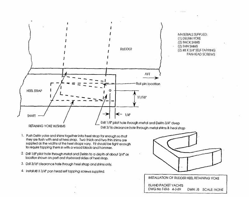

the IP catalogue has rudder shims for 80 bucks. How do I know I need them, and where is the article that had described how to install them on an IP35?
I have searched to no avail.
Steve

The factory will upload or share the document Monday. It is in the building and it is the weekend so they will take care of this then.
14 years 11 months ago - 14 years 3 months ago #1104 by hayden
Replied by hayden on topic Re: shims for rudder
Steve:
Here is the information provided by the factory. It looks rather simple to install the shim.
