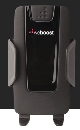

Last Topic, I want to boost the Cell Signal
I agree, but even with a regular cell, I was able to get BTC at Great Sale Cay which is 22 miles from Freeport and 10 miles from Grand Cay where the cell towers are located. Usually the cell will connect about 8 miles off shore. But, to boost the signal, next year, I will be adding a Wilson Electronics cell booster. These can be read about at their web site now called www.WeBoost.com or you can buy from www.3Gstore,.com. I will be adding the WeBoost Drive 4G-S
SKU 470107
That has all 4 bands covered, BTC uses 850mhz and 1900 mhz. This should really help as well, it is not needed, but I am going to add this to the boat next year and only use BTC data not WiMax. This booster can also be used in the USA as well, but check the specs.
store.weboost.com/products/drive-4gs?_ga...184193987.1431473835
OK, I hope this helps you connect to data in the Bahamas. I would love to hear from others and their experiences and their set ups.
