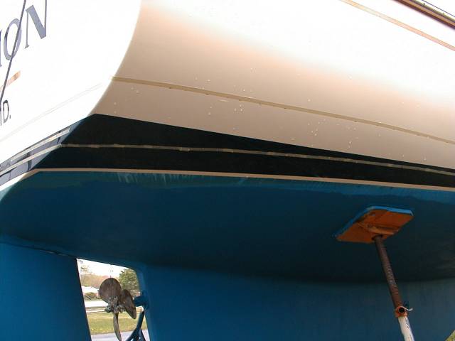

We did this exact process to IP27 Cinnamon and I can share some challenges. First issue is getting this straight and level. That is not easy. With the boat out of the water, rent a laser transit and place this midships about 10 feet away. Then mark the bow and mark the stern where you want the line to be. Then turn on the spinning laser transit and tilt the tripod and legs until you get it hitting the bow mark and the stern mark. Walk down along the boat and place small tape markers on this line about 12-24" apart. Start your masking tape at one mark, then pull out about 10 feet of masking tape, stand back and pull tight, then slowly move in towards the boat getting it to stick at your 12"-24" markers. If you only have an arms length of tape pulled out then the line will be very wavy due to the short use of tape. Pulling out 10 feet and keeping it tight is a great way to go as this give you a long line and you slowly move it into the boat. The laser transit gave you the straight and level markings, but applying the tape is also a trick to get it level. Transits can be rented at most tool rental shops.
Here is a link to our photos of this job, look a the bottom of this page where we sold Cinnamon.
fhayden.com/cinnamon/
Photo of tape pre-paint job. Note: The yard that painted this first, really messed it up, and we had to redo it.
