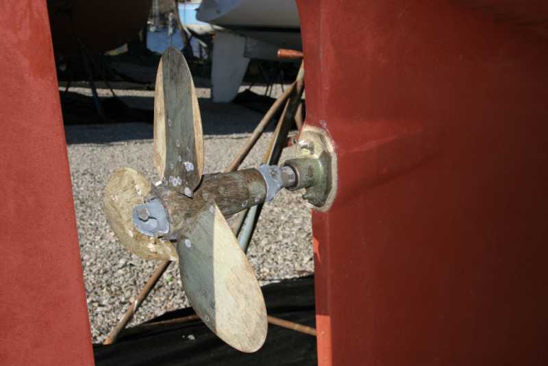

Here's an update on the condition of our Trinidad SR bottom paint. We just pulled the boat for the first time in three years and was only power-washed. It's been 18 months since we had a diver scrub the bottom and replace the anodes. The overall condition of the paint is very good but does show some wear around the water line which is understandable since that gets scrubbed more often. The only barnacles were attached at the forward part of the keel where we had scrubbed the paint off completely by running aground :whistle: . We plan to do a light sanding and add a single coat to the hull and two coats at the water line and other hard wear areas. We'll have to put on a barrier coat and two coats of Trinidad where the fiberglass is exposed.
I also want to report on an anti-fouling paint for metal that we used. It's called PropSpeed (www.propspeedusa.com/). This was also applied three years ago and when seeing the prop for the first time I was impressed. There was some barnacle growth but not enough to cause serious fouling. The cost of the paint is up there with silver and some other precious metals but it definitely works. The company claims up to two years between applications but after seeing this I'm comfortable with stretching that to three. At least here on the Chesapeake.
I prefer not to have the boat pulled every year since we live aboard. The combination of Trinidad SR bottom paint and PropSpeed ensures easy maintenance and long periods in between. I might be wrong but I also believe the hard bottom paint is better for the environment than ablative paint. The PropSpeed is said to be environmentally safe.
