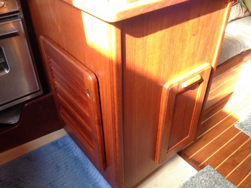

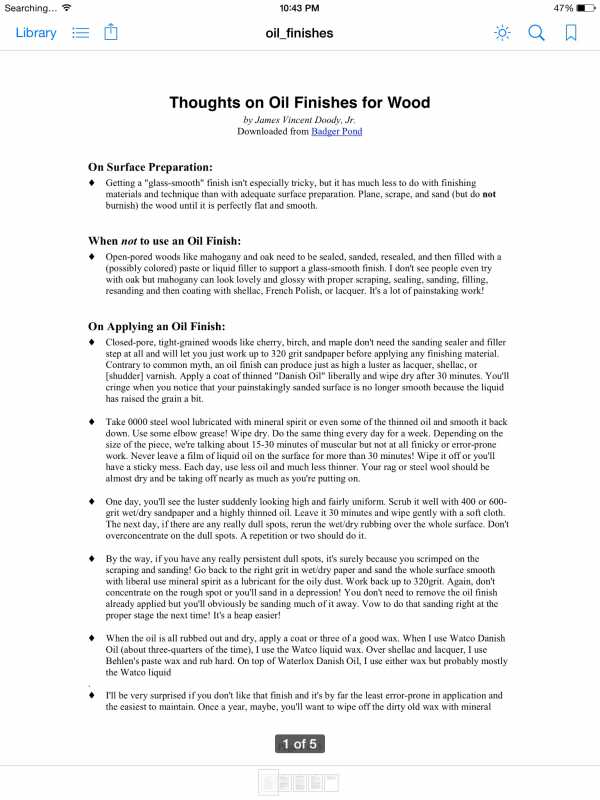

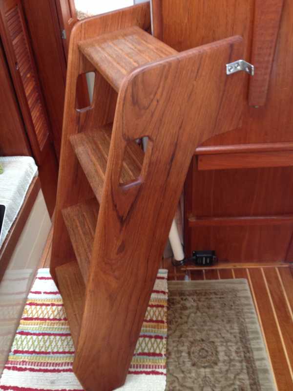

- for cleaning I got good results with the "bar keepers friend", a liquid version of oxalic acid. They are available at lowes, Home Depot, etc. Then I began the slow process of making it "glow" using the recommended techniques and oils in the attached article: I used Danish oil, and Danish oil rejuvenator, and mineral spirits, also available at lowes. . I have since began to use the same techniques on all my interior wood. I do not use the oxalic acid on the bulkheads though. Instead I wash with mr clean and water, then I rub well with mineral spirits and a gray 3m scrub pad. Then I begin the slow process of getting the "glow". Read the attached article, (I also included a picture of the first page of the article) to learn how to create the glow. It is actually very enjoyable. I pick a section of the cabin to do at a time, then move on to a different area when the.mood strikes. Please read the article, and you will begin to understand. Every boat and every panel has it's own characteristics. After a while you will get a feel for it. It is much more like growing roses than applying a finish to, say, an automobile metal surface.
www.woodcentral.com/bparticles/oil_finishes.pdf

WOW!!!!!! That looks fantastic. Now you can provide this service to other IP owners! Great job and thanks for the details and steps you went through.
Hayden in Hope Town Bahamas
