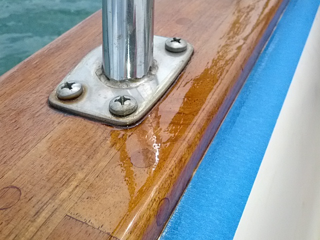

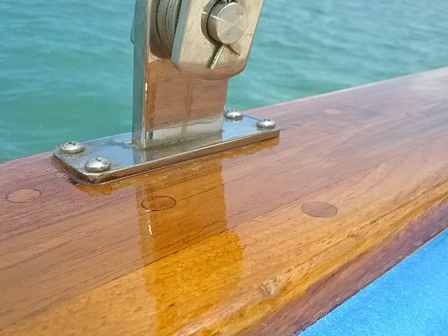

I just finished a service coat on my varnish of Epifanes. Here is how long the job took broken down into tasks.
Area serviced: Bow to side gates gunwales
IP35
1. Sand with 320 grit: 30 min.
2. Tape, dust, remove gear, wipe with denatured alcohol: 45 min.
3. Brush on one coat. 60 min.
4. Clean up: 15 min.
Total time: 2 he's. 30 min
Left to do...re install gear, jib cars, strike plates, sheets. 30 min.
I am always amazed at how easy and quick a service coat goes. I also like to break the boat up into sections. By doing sections, it never is a big job.

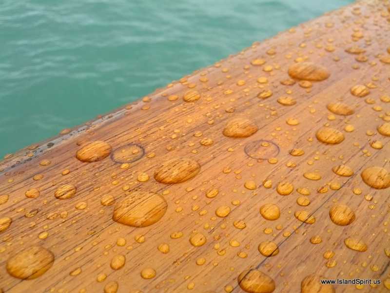

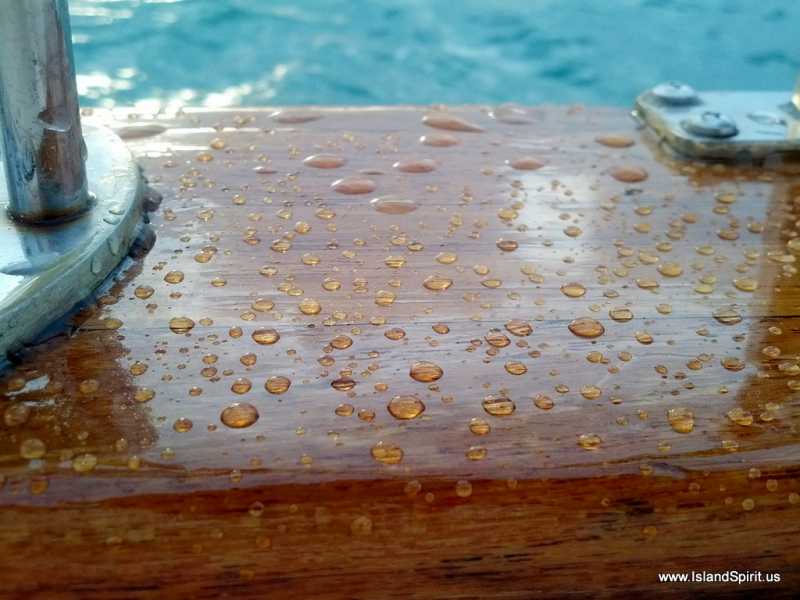

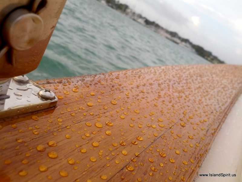

Epifanse is a great product. Look at the day after with the rain on the new varnish!
