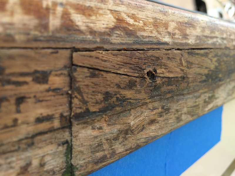

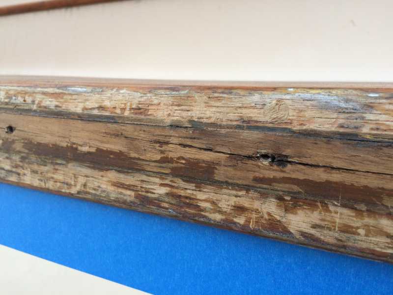

We are in the middle of cleaning and varnishing the rub rail on our IP32. We took the metal part off and are now working on the teak underneath. Several of the screw holes have cracks along either side of them. Should we fill the cracks with something before we put the metal part back on? If so, what would y'all recommend? I will add a picture here, if I can figure out how...

10 years 11 months ago #4399 by mluskin
Replied by mluskin on topic Re: Exterior Teak
If there's any rot in there try Smith's two-part liquid epoxy that's designed to seep in and replace the rotten wood with resin. They also make a two-part paste that will fill the cracks. Check instructions and video on the Jamestown Distributors site. I've had good luck with these. If there's no rot then just use a bedding compound or marine silicone for the screws.
10 years 11 months ago - 10 years 11 months ago #4427 by Angelfish
Replied by Angelfish on topic Re: Exterior Teak
mluskin wrote: If there's any rot in there try Smith's two-part liquid epoxy that's designed to seep in and replace the rotten wood with resin. They also make a two-part paste that will fill the cracks. Check instructions and video on the Jamestown Distributors site. I've had good luck with these. If there's no rot then just use a bedding compound or marine silicone for the screws.
Thank you for your reply! What we did is mix a little teak saw dust with resin and filled them in with that. Some of the other places I filled in with exterior wood putty. We've finished all the sanding and will start varnishing tomorrow. It really does look nice at this point. While we are on the hard, it just made sense to do the rub rails. So far, we've done the hand rails and eyebrow. After we get Whimsy home to our own slip, I think we will do the cap rails and put maintaince coats on the hand rails and eyebrow.
