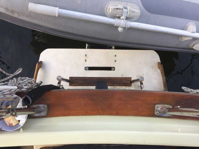

10 years 10 months ago #4305 by Kurtclem
Swim Platform added in IP35 was created by Kurtclem
We added a swim platform to our IP 35, I simply used 2 pieces of 5x2 3/4" starboard, bolted together cut to shape if boat, attached with and aluminum angled bracket along backside if boat and 2 stainless steal brackets all bolted together, cut slated holes on bottom. It has served us well!
The following user(s) said Thank You: Emergpa1, Ed Finn
7 years 8 months ago #6537 by Augusta
Replied by Augusta on topic Swim Platform added in IP35
Hi Guys, I see this post is from 3 years ago so not sure if you are still active on this forum or not. But I'm thinking about adding a swim platform to my IP35 and wondering how you decided on the height above the water line? Just where you thought it looked good, or some technical reason for the placement. Thanks, Joe
7 years 8 months ago #6540 by hayden
Replied by hayden on topic Swim Platform added in IP35
Joe:
The swim platform should be mounted where it will remain above the water when under sail or power. The stern wave on an IP 35 (ie. the black grease line) is your line you should be above. This turns out to be just over the exhaust. That is the place to mount it on an IP 35. I have seen many mounted in different ways. Some with support braces under the platform some with them above. It is all up to your welder.
If I were to ever add one, it would much narrower than most that I see. It would also have top support bars that run down to the outer corners. This way when you lower the dinghy these bars allow it to slide down and past the platform.
So, keep it narrow, maybe 12"-18: wide, just enough to sit on or stand on. Run outer supports to guide the dinghy down from the davits. Make the platform out of fake teak. That's what I would do, if I wanted a platform.
I board from the side, it is lower, easier, and more calm.
Hayden...on IP 35-165 in Stuart Fl heading to Caribbean Sea
7 years 8 months ago #6542 by Augusta
Hi Hayden,
Much appreciate the reply, all good advise. I really hadn't thought about just boarding from the side, I'll have to give that some thought. Have fun in the Caribbean, I'm jealous.
Joe
7 years 8 months ago #6543 by hayden
Joe
Look up at defender a "fender step" you hang this at your side gate. Then we tie the dinghy bow off at midship cleat and a stern line at just aft the gate to the lifeline. Now step onto the dinghy side tube, then onto the fender step then onto your deck. Much easier boarding from the side.
Some even add a nice ladder there.
Something to think about.
