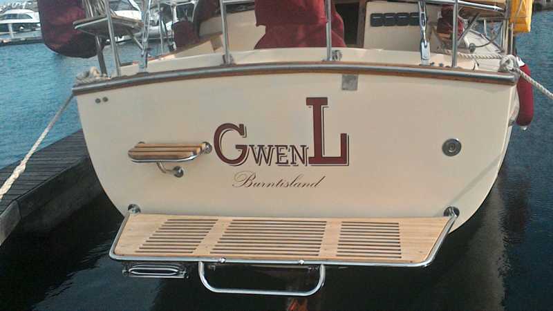

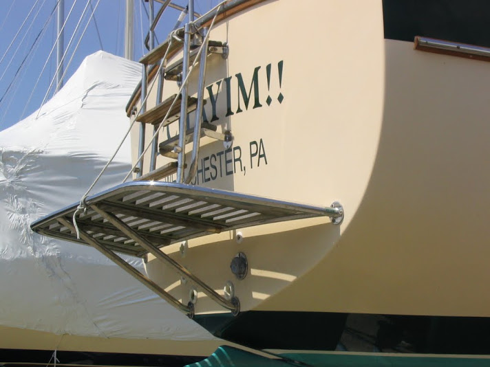

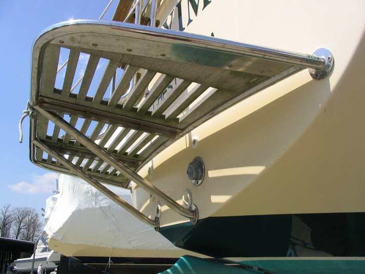

Here are photos of an IP38 with this platform and how it is installed.

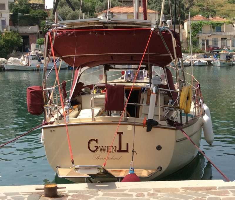

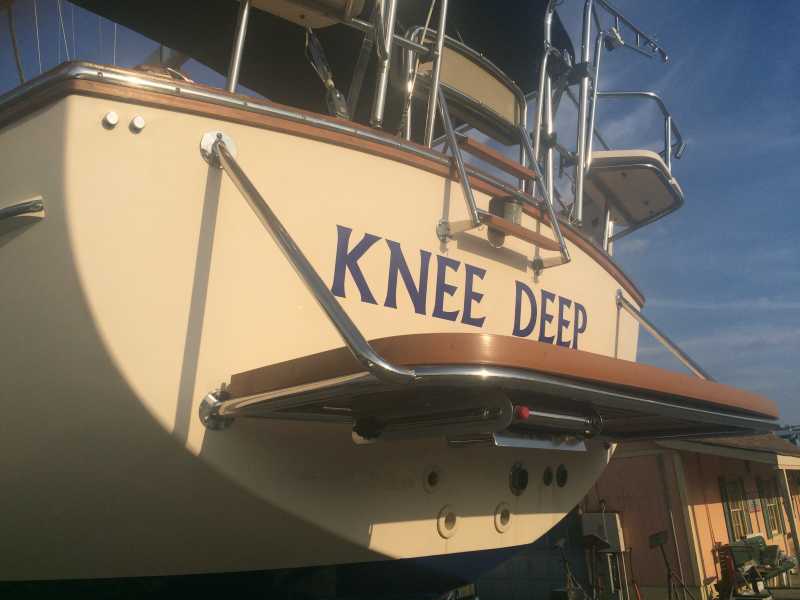

After our first season in Greece we decided that a swim platform was a necessity. It would be great for swimming but also make stern to mooring much easier. Importing a platform from the states proved to be too expensive so we gave the work to a local company and are delighted with the results. The fixed transom brackets are fitted with pins so that the whole platform can be easily removed should we decide to venture out of the Med. As all mooring in the Med is stern to, a boarding ladder is also a must and this can be raised and lowered via one line. We also opted for a telescopic ladder fitted under the platform to keep the area clear and rather than re-use the old boarding ladder we had a stainless steel and teak step fitted on the transom.

11 years 2 months ago #4052 by hayden
Replied by hayden on topic IP38 swim platform
Mark:
Your swim platform is really nice. I really like how you worked out that small step to the left side. Beautiful job. I really like all these swim platforms and how people add them and solve the issues. Thanks for sharing these photos.

We're about to meet with a couple local shops to tackle our arch and swim step and really like yours. If you don't mind could you share how you tackled the transom step? How is this mounted, did you remove the eater heater for access or go another route?
EB
  • markrodger
  • markrodger's Avatar Topic Author
10 years 10 months ago #4285 by markrodger
Replied by markrodger on topic IP38 swim platform
Yes the heater was removed to provide access, replaced all the hoses at the same time. Tough job but worth it

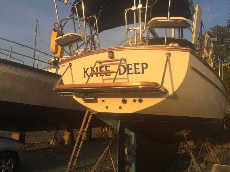

Here's our swim platform on our IP40. Stainless and Plasteak. We used existing swim ladder as steps to cockpit. Pivots up when not needed. Had it done locally in Norfolk.

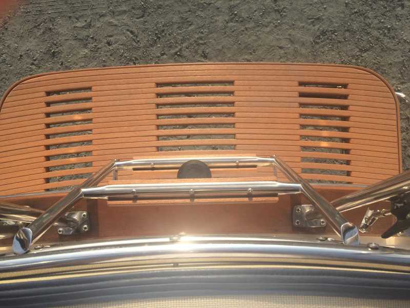

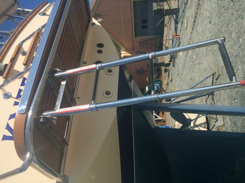

Found a 4 tread telescopic under mount ladder on e bay, similar to the one in the attached photo. This was mounted under the swim platform (see photo from precious post) and works really well. Although it was made in China the quality was very good, I wash it down regularly with fresh water and keep it well lubricated with silicon spray so far so good.
