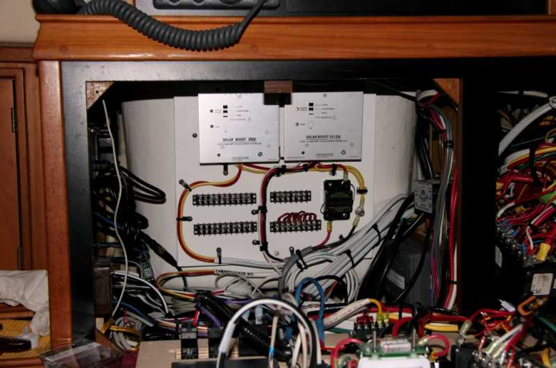

Mac - We currently have two Kyocera 85w panels and are in the process of adding two 140's to that. We originally went with Kyocera for the larger panels but were talked into Solarworld Sunmodule 140's by our local supplier, MTS in Deale, MD. They mentioned quality of construction and price but I think it's probably a push. For controllers we have two Blue Sky controls, each rated at 25 amps. Our boat was set up with one of these already when we bought it. The factory said you shouldn't mix different size panels on one controller and our total potential output for all four panels is 37 amps. We now have two Blue Sky controllers daisy chained together with a small remote readout mounted at the Nav Station. These controllers need to be mounted close to the batteries rather than the panels because they provide a boost which would be minimized over the longer wire length from the panels. Ours are mounted inside the Nav Station cabinet about 3' from our house bank (see photo).
