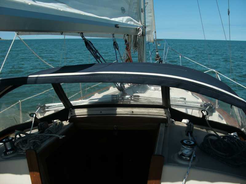

Tom:
You can add blocks to the end of the traveler track and then control the main sheet position from the cockpit. Garhauer Marine makes the best gear and it is all USA made. Look at this link to see their systems.
garhauermarine.com/catalog_process.cfm?cid=34
I bet you could add the MT-3 traveler to your boat. See this image.

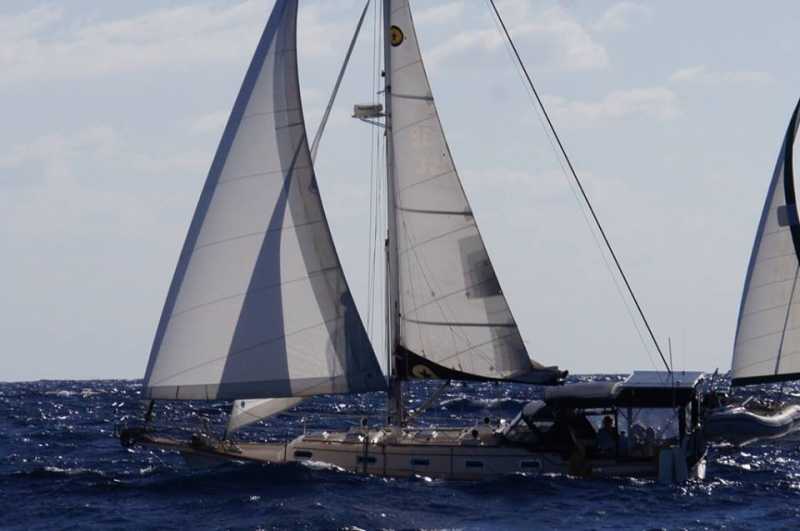

11 years 3 months ago #4095 by hayden
Replied by hayden on topic IP 27 Traveler - cockpit controls
This is a good time to use a solid boom vang. Sailing from Eleuthera to Abaco Bahamas. See this image.
