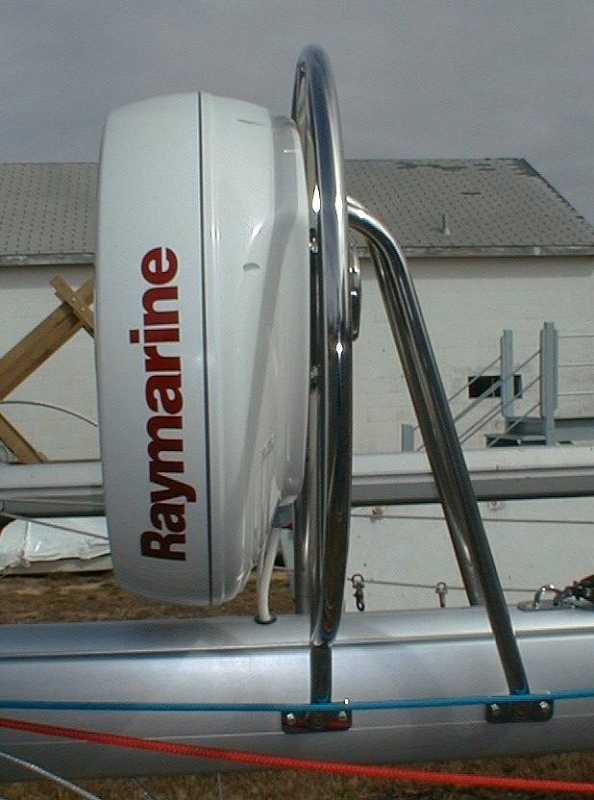

We mounted a KATRO radar mount to our mast on the IP35. This mast also has conduit with wires. We drilled and tapped holes and bolted ours to the mast. You can see full details of our radar mount on this 2001-2002 commissioning page.
fhayden.com/rockhallfleet/islandspirit/radar.htm
