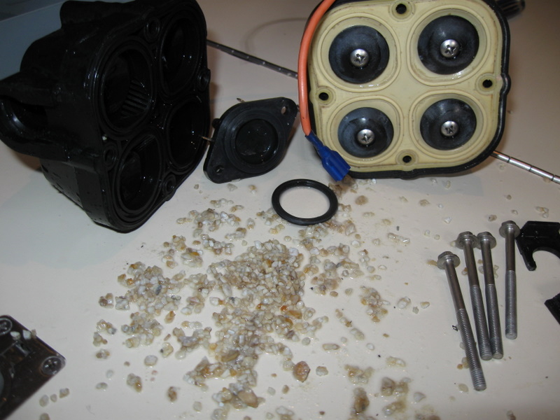

I ended up putting a Jabsco 5.o Variable Speed pump in. It works great after I figured out what the real problem was. The fresh water pickup tube on the tank was completely clogged at the elbo connection on the top of the tank. The bottom of the tank also had a bunch of rice size white deposits apparently caused by a reaction between the chlorine and aluminim tank. I used a shop vac to get that cleaned out . The pump will run all the fixtures at once and you cant even hear it run unless you expose it in the compartment. A also replaced all the 1/2 inch fittings to 3/4 from the tank to the pump. The original installation although pretty provided a couple of weird 90 degree turns that had the hose cinked in two places. Im very happy with the outcome. The pump cost about $200 and it took me about 2 hours to complete the job

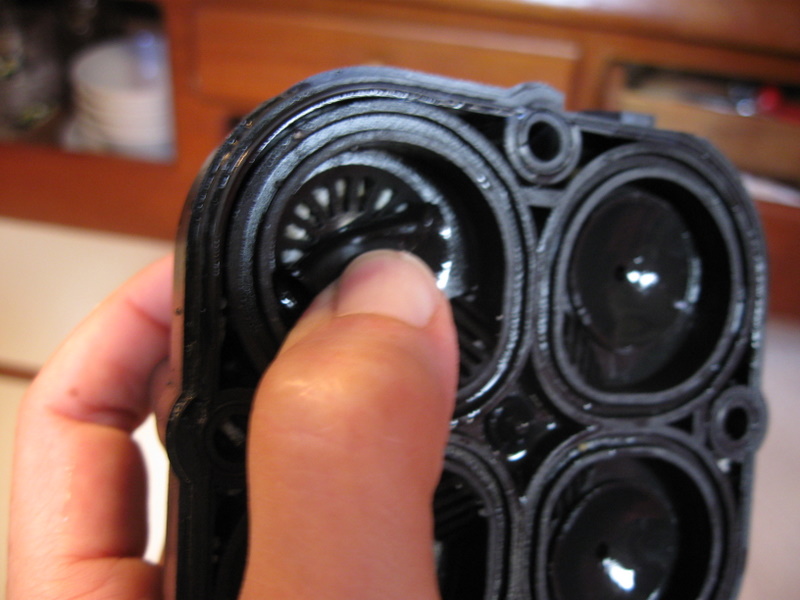

That is a very common issue on IPs, the water pick up tube TOP at the 90 degree bend where it enters the water hose. If you are not filtering out the chlorine during water tank fill, then the take does get these alum chloride crystals which plug up the pick up tubes and the pump and the screens. Check out these photos of when I cleaned out my pump due to these particles...
