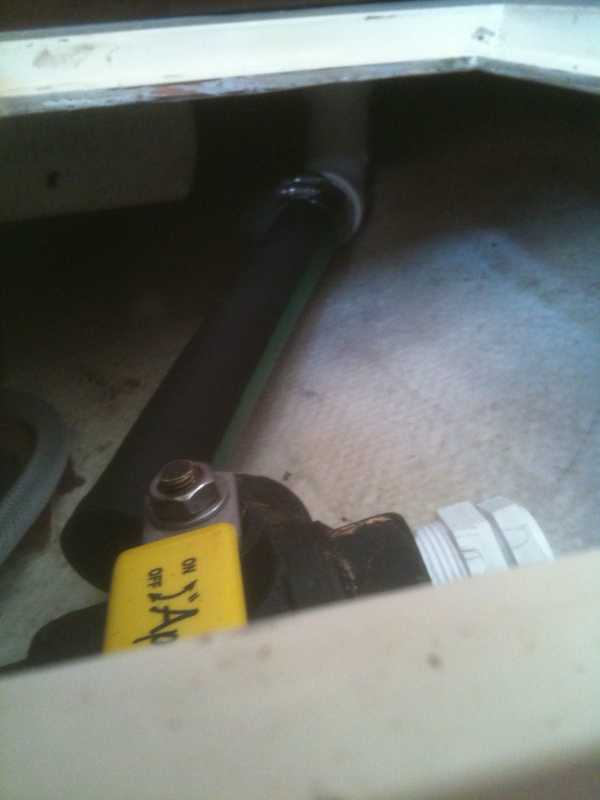

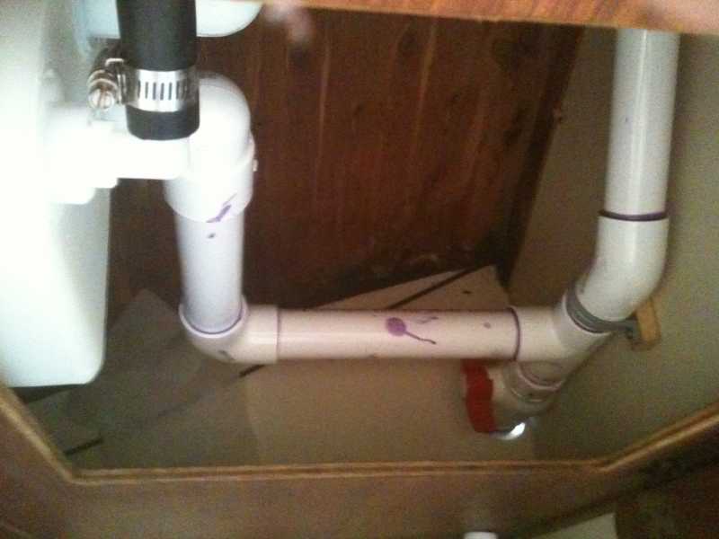

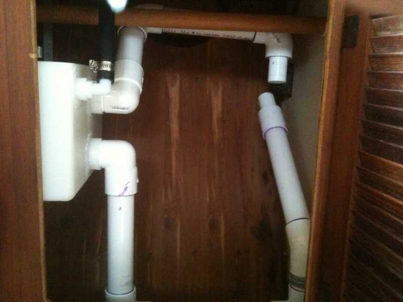

I have a 26 Mark II which is similar to your 27. I replaced the entire waste system, but did not want to add the cost and complexity of a macerator pump and y-valves for the type of weekend cruising I typically do. So, I devised a gravity discharge system by mounting a rectangular tank in the locker behind the head, in the area left of the door. To minimize head hose and connection odor, I used Schedule 40 PVC for much of the run, using only a few feet of high quality hose to make the connections to the pump out, head, and overboard discharge. The head discharges directly to the tank. The tank can be pumped out as usual, or by turning one valve, can gravity discharge when offshore. It's pretty simple and eliminates over 20 feet of flexible hose. The short lengths of flex hose prevent damage to the rigid pipe and make the system accessible. I like Hayden's suggestion about counting pumps - never thought of that and will have to experiment with the capacity based on pumps.

14 years 1 month ago #1374 by cemcdonnell
Replied by cemcdonnell on topic Re: Waste System in IP 27
Gerry, there are a few things I would do differently if I had a do-over, but overall I'm happy with my choices given the way I use the boat. To answer your questions, I used Shields Poly X sanitation hose - I bought a 12 foot length and used about 6 feet to make all connections, and like Hayden, used the Sealand PVC to hose connectors. They are inexpensive, easy to use and reliable. I cut the sanitary hose to the size needed, then left it on the deck in the hot Florida sun for an hour. Connections wiggled on without lubrication. I removed the original IP tank (11 gal?) from under the V-berth (not sure where yours is) and threw it out. It stunk really bad -- it was the original plastic tank. That space I now use for storage. I removed 20+ feet of smelly sanitation hose in the process. I read somewhere that the manual pump on my Raritan head could push waste at least 3 feet high, so I tried to keep the upper tank fitting below that height, and pumping to the tank has not been an issue -- and it's only a few feet. I did not use a check valve, but at the end of every day, I pump clean water to clear the line to the tank. You don't want waste sitting in the flex sanitary hose. For the tank, I purchased a Moeller linear polyethylene waste tank (Jamestown Distributors has them) on Amazon -- I think it was the 6-gallon size but I'm not near the boat to verify -- on the theory that in my case, less is more. I didn't want gallons of waste sitting in the tank for long periods, so the smaller size forces me to dump more frequently. A larger tank with more height and volume would certainly fit, but it likely will need to be a custom made unit that tapers to the bottom. On the drain side I installed a PVC line to a PVC tee -- one side leading to the deck pumpout, the other to the through-hull discharge. In the latter, I installed an inline valve to shut off the the drain line. That was both to direct waste to the deck pumpout when vacuum is applied, and to prevent waste from sitting in the lower flex hose just before the through-hull. To drain the line, I shut off the upper valve first before closing the through-hull. And yes, you can see the level of waste in the tank through the opaque poly tank. I can still use the locker for some clothes, but space is very limited. One other idea you might consider. I converted to mostly fresh water flush by tee'ing off the water tank with a line to the seawater intake line using inline pvc valves and a check valve to prevent backflow to the water tank. Fresh water also helps keeps smell at a minimum. The seawater line is still there and I can switch back to seawater flush if needed by throwing two inline valves. I have some pictures if I can figure how to upload.
Chris McDonnell
Even Keel
IP26-053
14 years 1 month ago #1375 by cemcdonnell
Pictures, I think. Chris
