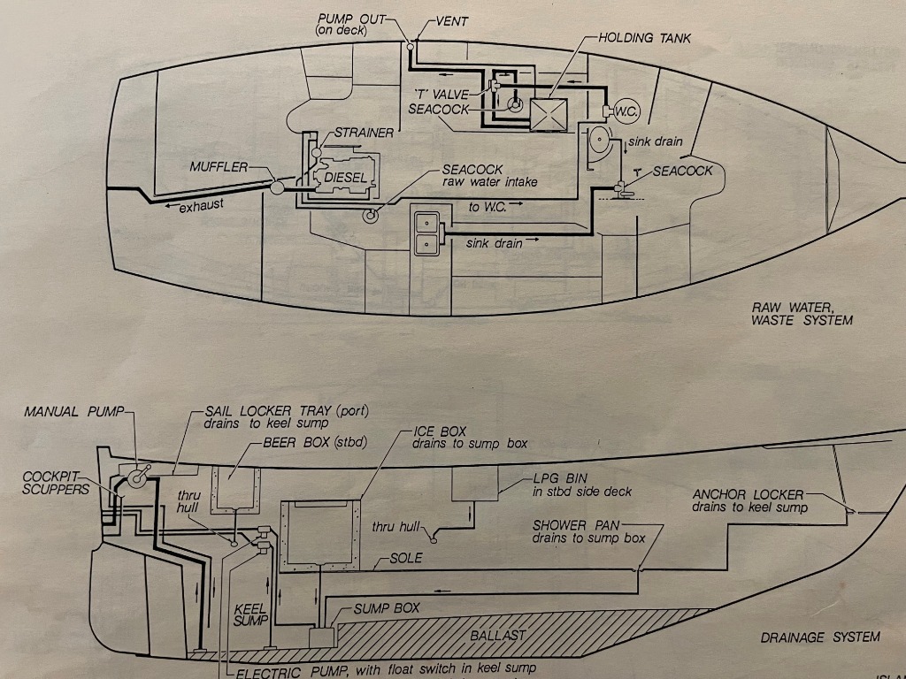

Hi. Our hose from the sea water to the head (Pulling sea water in ) is rotting and starting to crack. We've also noticed the hose from the to the drainage sea cock is rotting.   We don't know how to access the hose to change it from the showers.  does anyone have a blue print for these hoses?  Its an 1989 IP 35

The Raw Water Waste System diagram in the IP35 owners manual describes the general layout of the water lines.

This is clearer than the one I had snd very helpful. Thanks

If you look into the DOCUMENT LIBRARY here, you will find the IP Owners Manuals.
www.ipyoa.com/docs
There is a lot of info on the build of our yachts in the manual.
