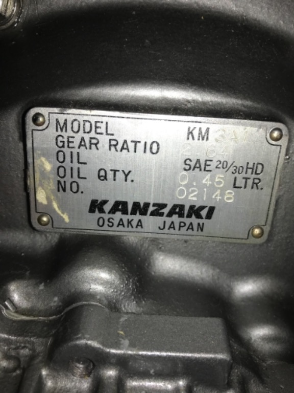

I just purchase a 2002 IP350 and want to be sure the engine oil and trans fluids are replaced.
I bought Shell Rotella 15-40 for the engine but am unsure of the fluid for the transmission. Any recommendations?
5 years 5 months ago #7042 by Katemba
Replied by Katemba on topic Oil change
I have IP38#22 (1986) and our transmission fluid is ATF. In fact it says so on the fill cap.
5 years 5 months ago #7048 by Dave 777
Replied by Dave 777 on topic Oil change
Hi ,
On our IP380 there is an id plate on the transmission that specifies the oil type. We use standard SAE 30 non-detergent oil. I also heard you can use ATF, but the regular oil was the manufactures spec.
