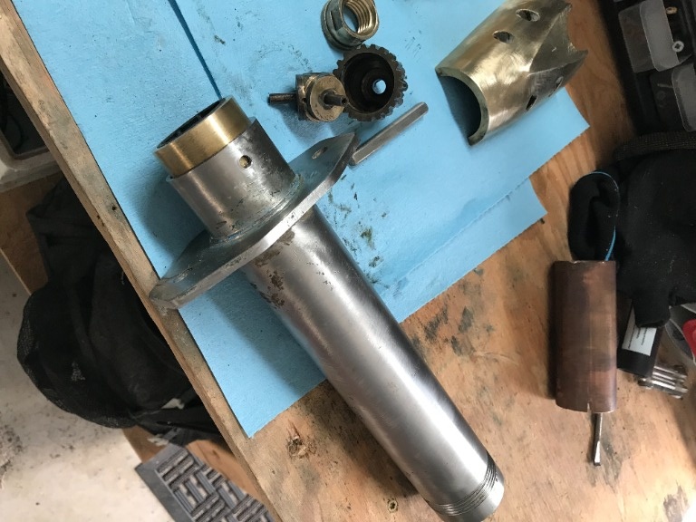

5 years 11 months ago #6839 by tschultz
Replied by tschultz on topic cutless bearing removal
IP370, we left cutlass bearing extended 3/8” from stern tube to allow for easier replacement. Notice finger nail polish on the zinc screw to slow deterioration

5 years 11 months ago #6845 by g.francis
Replied by g.francis on topic cutless bearing removal
Harry,
I don't know the specifics of your boat but from my perspective expect to need to press the bearing out which means removing stern tube. I cut the bolt heads off and pushed the bolts in. Mark the top of the stern tube with a chisel so that it goes back the same way. I cut the stern tube back a half inch so the next time it comes off without removing stern tube. Buy new bolts and nuts and put the heads inside, much easier. Either notch the bolt ends to tighten with a screw driver or grab lightly with pliers to tighten. Before tightening up completely check the shaft is centered in the stern tube and that it spins okay. I am going in the water tomorrow so I will let you know how close the alignment is. Hoping for the best.
