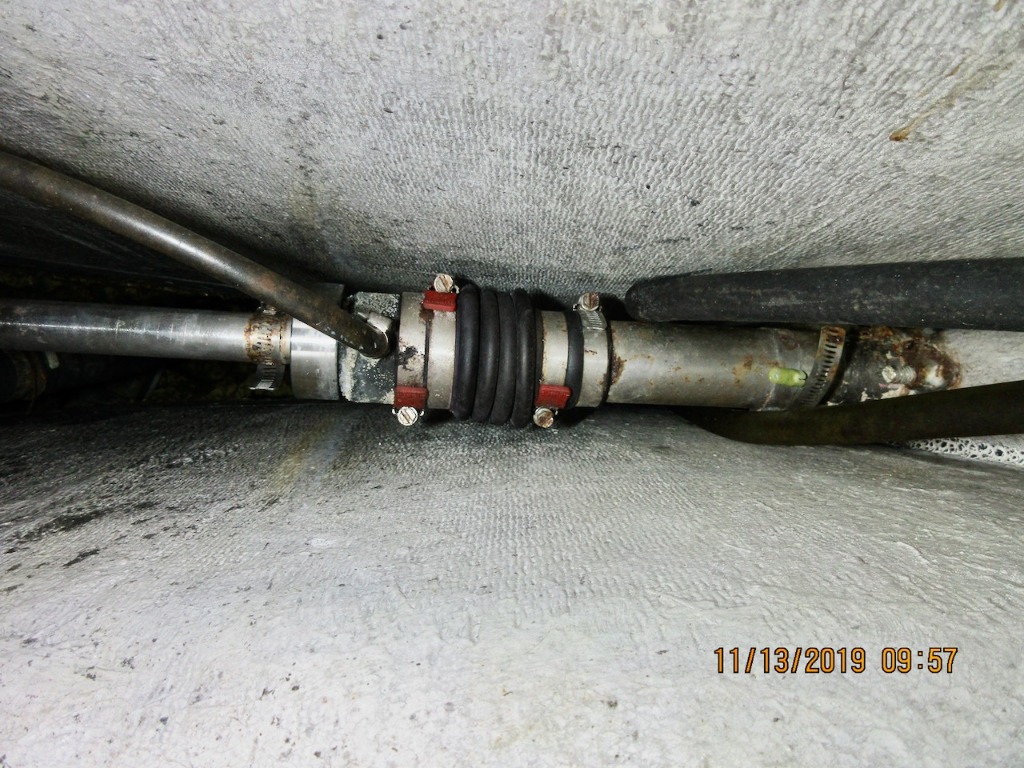

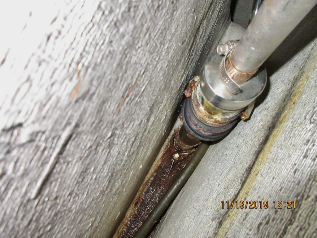

Thanks. I am looking to close on a '91 IP 32 and the shaft tube appears to be corroded to the point at which at a minimum needs to be pulled and inspected, possibly replaced. No readily apparent leakage is observed.

6 years 11 months ago #6693 by hayden
Replied by hayden on topic 1991 32' Island Packet Shaft Log
Bill:
Your photos look like that is a PYI dripless shaft seal. Did the survey call it out? The rusted set screws are what you use to move the disc up against the bellows to seal the system. Spray it all with PB Blaster to looses and then maybe it can be adjusted. Or replace it all with the standard factory stuffing box and packing material.

6 years 11 months ago #6695 by Coldrick
Replied by Coldrick on topic 1991 32' Island Packet Shaft Log
Yes, the survey did call it out and it (drip-less) will be possibly replaced especially hose clamps. Would you happen to know what the original prop (3 blade fixed) would have been?

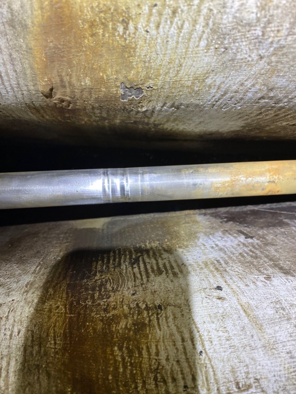

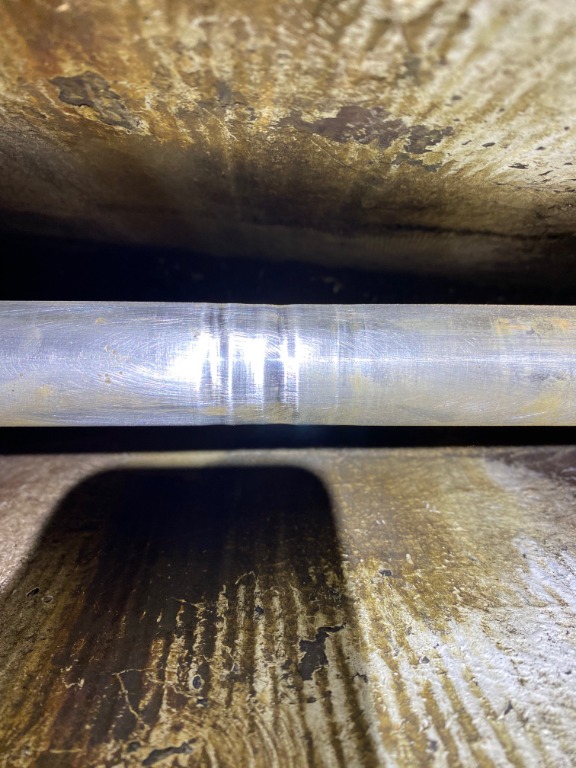

5 years 8 months ago #6921 by stevetrego
Replied by stevetrego on topic 1991 32' Island Packet Shaft Log
Hayden- I've been searching various post and your name appears quite often. Thank you for contributing your knowledge! Because of it I wanted to see if I could ask for your input on the followiing.
I have a 2000 IP380 and just replaced the cutlass bearing. I couldn't pull the shaft out due to the rudder but able to squeak the shaft log by it. When I put it back together I noticed still movement of the shaft in the new cutlass. Not sure why I didn't notice the wearing of the shaft before put it appears to be fairly warn where housed by cutlass and is the where the packing was in the stuffing box. Do you have any expereince with this and how far could I go before it becomes a larger issue? I have attached images that show the packing groves. I am on the hard now and not sure if I want to tackle droping the rudder.
Thank you in advance!
Steve
5 years 8 months ago #6922 by hayden
Wow! I have not seen that kind of grooves on the prop shaft. I might look into a new shaft. To remove it all you need to remove the stern tube. Then the shaft goes past the rudder.
Looks like the packing nut rubbed the shaft.
Also, maybe the stern tube was pulled and flipped 180 when reinstalled. These stern tubes have a slight angle for up. It could have been put back in upside down. We all hammer absent or marking into the top do it goes back in right.
5 years 8 months ago #6923 by stevetrego
I was afraid you'd say that LOL. But think you are right. There's the same wear along the area that's inside the cutlass. I was thinking it was just from normal use. It has about 2200 hours on it. I did try to pull the shaft past the rudder but no lock without having to notch the rudder, or remove. You are probably right about the stern tube as that would make sense of a cause due to alignment. Unfortunately it has a mark at both top and bottom or vice versa LOL. I thank you for the quick response!.
