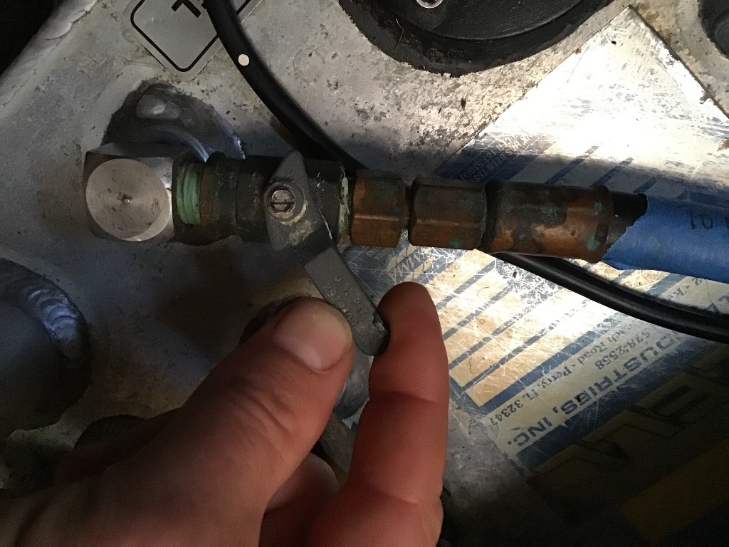

That said, we did have a stalled engine problem. Mechanic traced it to clogged shutoff valve, right after elbow on top of the tank. Valve diam was about 1/8 inch. I didn't realize that you can remove the fuel hose at the tank, and there is no back flow or fuel spill - thus waited for mechanic. Clog was some algea sort of glop. Easily cleared and engine ran fine.

Thank you Drew, very valuable information about that shutoff valve! I understand this is not that small tap by which you can shutoff the fuel pipe manually (see picture), but a second one higher up the fuel pipe which cannot be seen nor assumed.
