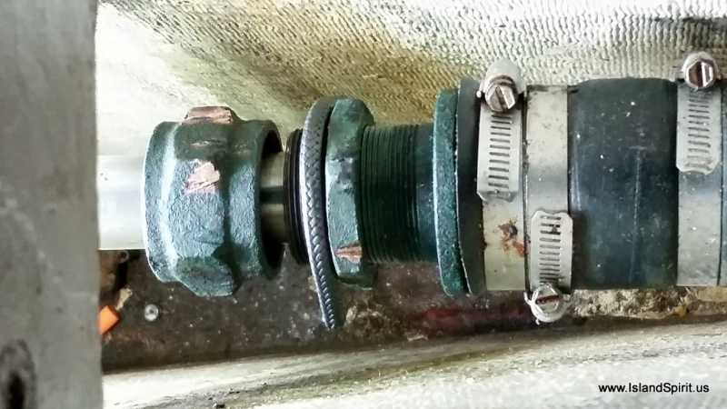

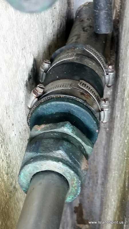

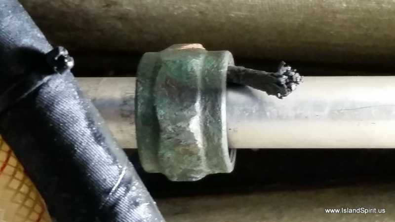

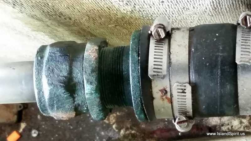

We have been using the GFO gore-tex packing material for many years and we find this to be nearly drip-less when installed. What I wanted to share is the fact that two rings of GFO in an IP35 packing nut seems to be more than enough. I know the rule is to install three rings of packing material, but allow me to defend my position. We have run two rings of GFO packing for many years. Today, when we repacked the stuffing box, I photo graphed the fact that three rings of GFO are too much due to the fullness of the 1/4" GFO packing. We have a 1 1/4" propeller shaft and this uses 1/4" GFO packing material. When we install ring number one, we then run the packing nut all the way up onto the stern tube to seat the packing material. Then we remove the nut and insert a second ring with the seam 180 degrees from the first ring. Now we run the packing nut up onto the stern tube to seat ring number two. This time, I looked at the amount of threads left. The I laid a third ring of GFO onto this area to see te amount of threads left. I feel that there are too few of threads left to make this a safe install. So, I only installed two rings of GFO packing. This is what I have done for many years and it works just fine.

Here are some photos

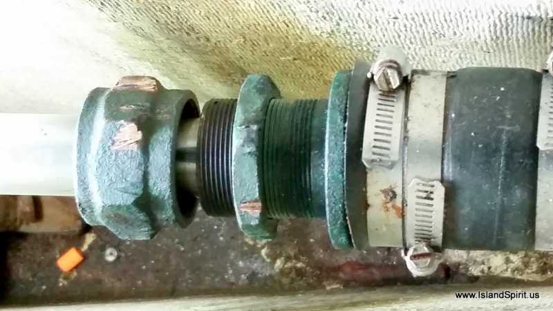

This picture shows the amount of threads that the cap nut threads up onto the stuffing box.
The locking nut is at the point where the cap nut is fully seated.
This picture shows the GFO Ring #3 and if installed would only allow a few threads in the cap nut.
The stop nut is at the position where the cap nut stops when seated with two GFO rings installed
So, I only install two rings of GFO.
Yes, I know it will compress, but two rings have worked well for thousands of sea miles....

Hayden,, We're looking to repack the stuffing box while EOS is hauled this week. Do you still recommend using only 2 rings or have you changed your technique to be able to get 3 rings in?
7 years 1 month ago #6608 by hayden
Replied by hayden on topic Stuffing Box packing with GFO gortex
I can only get 2 rings of GTO into ours, if you can get 3 rings in go ahead. I am running with 2.
7 years 1 month ago #6610 by zionsail
Replied by zionsail on topic Stuffing Box packing with GFO gortex
Thanks Hayden. I ended up with the same result …. with 3 in I only had about 1/2" of threads engaged and had difficulty getting the locking nut to travel that far forward. I removed the third ring and went with two.
Pete
7 years 1 month ago - 6 years 7 months ago #6611 by hayden
You are welcome, Pete. That's the same results I had and I was not comfortable with so few of threads into the cap nut.. it works just fine with 2 rings.

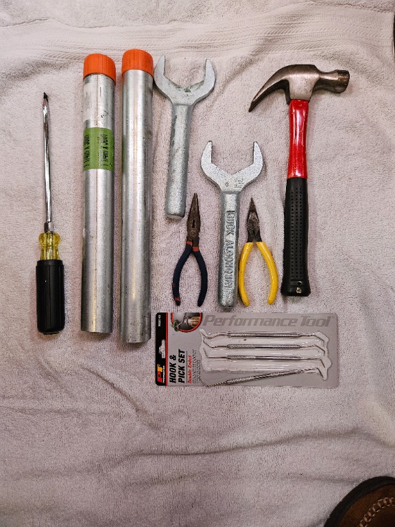

All the tools required to repack the stuffing box.  Prepare by squirting PB blaster on the acking and lock nut 24 hours before you attempt the repack.  When ready, smack the locking nut hard 5 times with the hammer. Use the Buck Algonquin 2 5/16ths wrenches with cheater bars to loosen the nuts. I used dental picks and needle nose pliers to tease the old packing out.  My buddy who ran the service department at a marina swears by burying a long drywall screw into the old packing and pulling it out that way.

    All the tools required to repack the stuffing box.  Prepare by squirting PB blaster on the packing and lock nut 24 hours before you attempt the repack.  When ready, smack the locking nut hard 5 times with the hammer. Use the Buck Algonquin 2 5/16ths wrenches with cheater bars to loosen the nuts. I used dental picks and needle nose pliers to tease the old packing out.  My buddy who ran the service department at a marina swears by burying a long drywall screw into the old packing and pulling it out that way.
