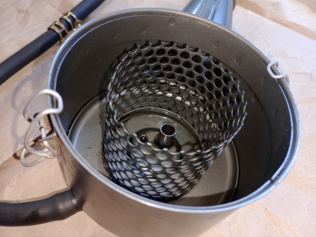

2 years 5 months ago #7519 by GB
Replied by GB on topic ENGINE BLOW BY ?
Hi Hayden, I’m replaying to this old post because i’m experiencing the same problem on my 1999 350.
I’m gomma to reduce the level of the oil from 3/4 to mid point but in the meanwhile i opened the air intake to be sure that air filter is clean and not clogged.
Inside the air intake I just found a not removable metal net (see picture)…Is this the filter or just the filter housing?
Thanks in advance for your help
Giuseppe
