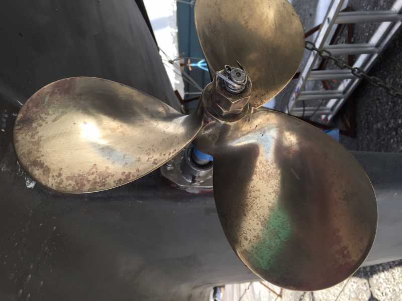

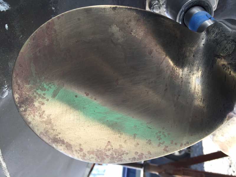

After removing barnacles, sanding, and polishing my prop I noticed that it's got reddish spots scattered around the blades. See attached photos. The prop is bronze. It spends summers in Long Island Sound, coated in Lanocote Anti-Fouling goop, which seems to slow down but not eliminate barnacles. The prop gets scraped by a diver once or twice a summer as well. The prop winters on the hard. Any thoughts about what might be causing this discoloration. Thanks as always.

Update: The folks at IP Home Port suggest that the discoloration is actually de-zincification of the bronze, due to no sacrificial zinc or insufficient zinc on my prop shaft. Sounds right: halfway through last summer I discovered that the zinc that was there on launch was no longer there, so the boat was without a zinc for 3-4 months. A zinc was put on mid-summer, and on haul showed significant erosion. I'll start with a new zinc this year and will also hang a "fish" zinc off the transom at prop level.
Lesson: Watch your zinc!
