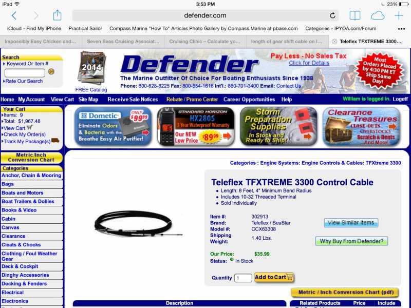

I replaced the control cables on my 31. It was a straightforward job for the most part. I did choose to change the route a little to decrease the curvature. The part you want are teleflex universal control cables. Universal refers to the type of fittings on the end. I think some other manufacturers use Johnson fittings. So get universal. You should measure your cables from end to end including the stud fittings on the end. I didn't want to take the old ones off until I got the new ones, so I used a string from end to end, running it along the cable through all it's turns, taping as necessary to hold it in place. then I measured the string.
