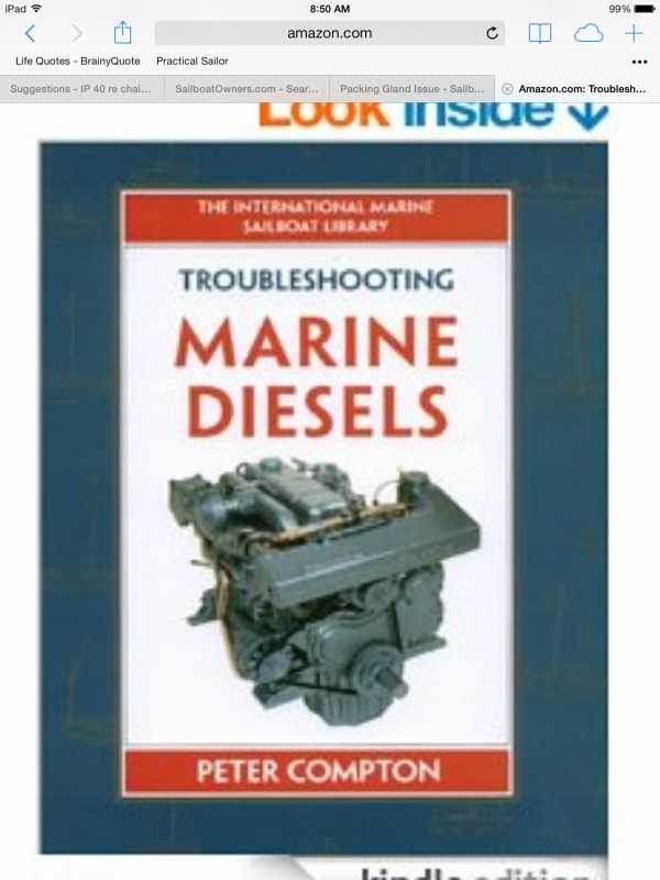

Don't underestimate your ability to work on this diesel. In fact I am sure that as time goes by, with just a tiny bit of effort, you will be doing your own work. Let me strongly encourage you to get A small blue hardback book called troubleshooting Marine diesel. It is a small but highly highly helpful book that will not only show you how to do many things on your own diesel, including troubleshooting problems, but will thoroughly familiarize you with the diesel engine. It is readily available from Amazon and you can see the cover on my avatar. The one beside the beer bottle on the beach in the Bahamas. You really must get it. Even if you have deep pockets and do not want to touch your engine, it will allow you to understand what is going on and speak intelligently with the diesel mechanics that you will pay dearly for. It will also help you avoid getting ripped off. It save you money by directing the mechanic to the problem quickly. Once you read that book you will almost surely want to get Nigel Calder's book on boat mechanics and systems, and the Yanmar 3gm30f manual.

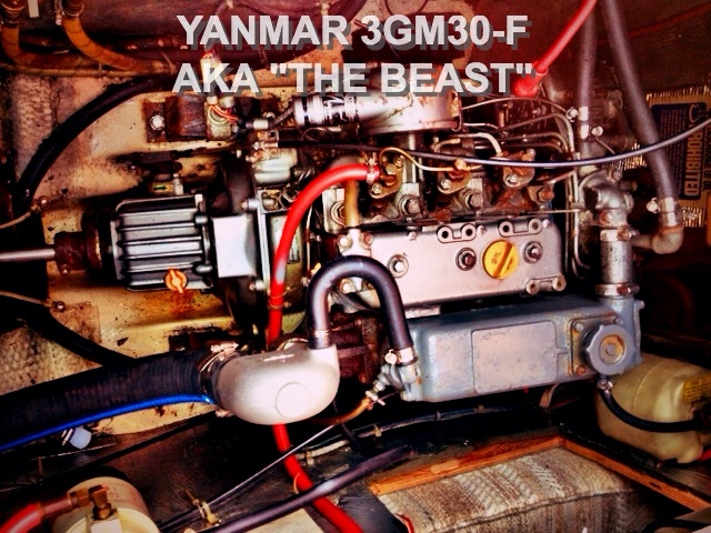

I saw Hayden's post about compression, and agree. However if the compression is good that does not mean you will not health problems. Two exceedingly common problems are with fuel cleanliness, and the subsequent problems with your injectors. Also, and even more common problem would be the cooling system. The exhaust elbow just aft of the heat exchanger is designed to corrode overtime and has to be replaced. I replaced mind and it was not a difficult job at all. Cost came in at under $400. The book above will explain that and you will understand what I mean almost immediately.
The diesel engine, when warm, should start almost immediately. If it is cold it may take a little bit of work. You understand about starters and not overheating them by trying to start them too long. If the engine will not start, then the first thing to suspect is air in the fuel line. If that is the case, I would bleed the fuel lines after replacing the fuel filter. The opening hatch I installed in the quarter birth to the engine compartment makes this exceedingly easy.
12 years 6 months ago #2696 by Emergpa1
Replied by Emergpa1 on topic Re: maxi prop zinc
PS, if you look closely you can see the cushion in the quarter birth and the opening I cut to allow access to the starboard side of the engine, the manual fuel pump and secondary fuel filter and most of the places where you bleed the fuel line.
She is a very sturdy boat and we are quite happy with her.

I think i've seen that diesel book. might even take a course. is there room to jump down inside the engine room? i like the idea of the hatch on the side of the engine. can you get to the packing gland easily?
