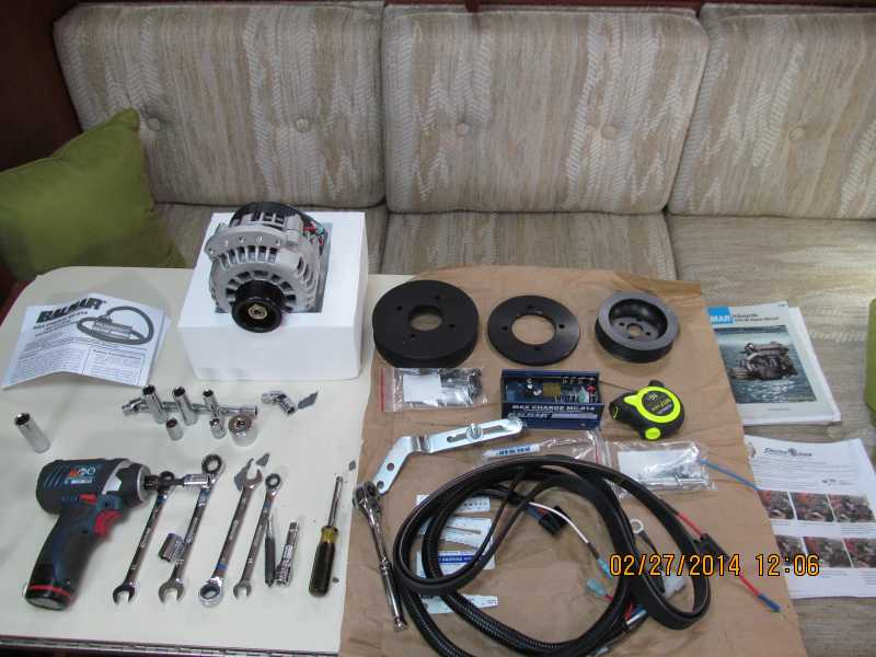

Overall the project went very well and I would do it again in a heartbeat. The kit fit well and was as advertised. The pulleys really do just bolt on over the old ones. And yes, it is possible to bolt them on backwards, but reversing the mistake is easy enough once you realize you have made it. I did have to call Electromax several times, sometimes two or three times in a day, and they were helpful enough. They do not work on weekends, and only nine to four eastern time. They also are gone for lunch and occasional meetings.
The kit is very well made, although the belt they sent me was too large, and i had to send it back and get a smaller one. They did charge me shipping on that. Also, the "tensioner" that comes with the kit does not work on our engine. So you have to tighten the alternator belt the old fashioned way. I rigged a block and tackle from the boom into the engine compartment and pulled up on the alternator to tension it.

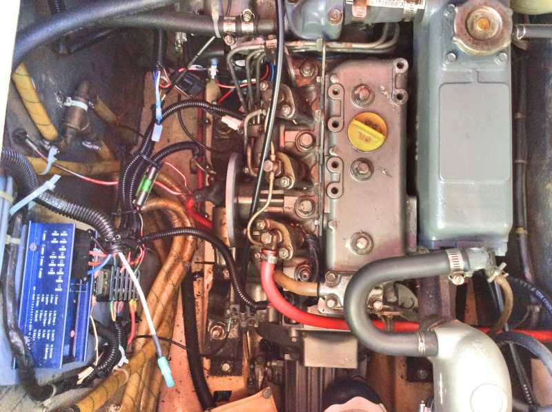

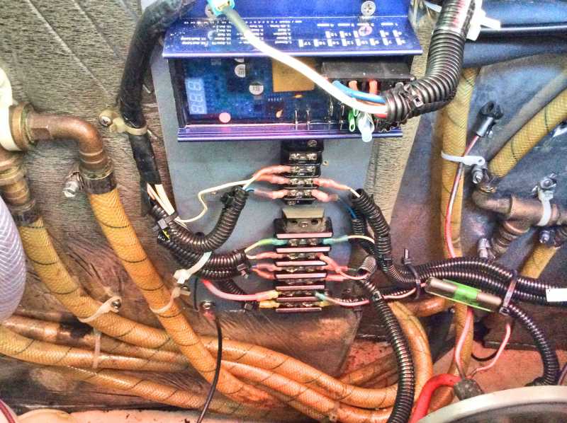

The whole project took about two weeks, off and on. I rewired my engine and instrument panel while I was doing the upgrade. I eliminated the plugs on the wiring harness and used a terminal block. The reason I did this was multifold, but basically I wanted to eliminate the corrosion in the plugs, and to completely understand the wiring. I am glad i did that and you can see the result in the pictures.

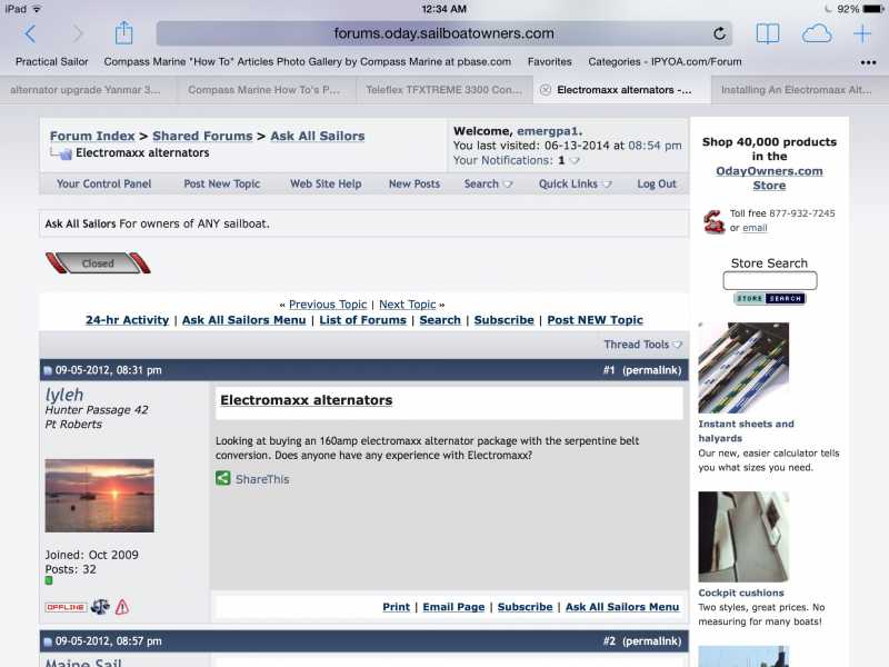

Also consider this link to the thread pictured below
forums.oday.sailboatowners.com/showthread.php?p=957603
