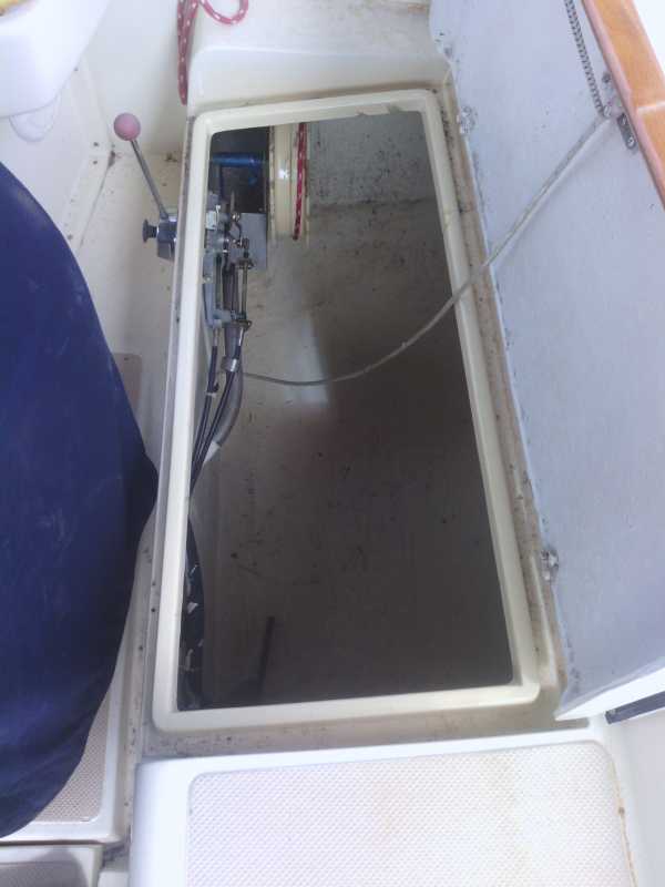

I have an 1987 IP 31. I am in the planning stages of a fuel tank replacement. The cutout of the tank from it's birth below the cockpit edsel pedestal does not look difficult. but the question is can the tank be taken out of the port cockpit locker hatch opening?
Unfortunately, no one at Island packet had any idea. I was told by two people ( Karstan Johnson and Jerry Swartz) to as this forum.
I have measured, but it is hard to tell without being able to manipulate the tank as it is not a square, rectangle or other easily measured item. And when turned may be able to squeeze through, or may not.

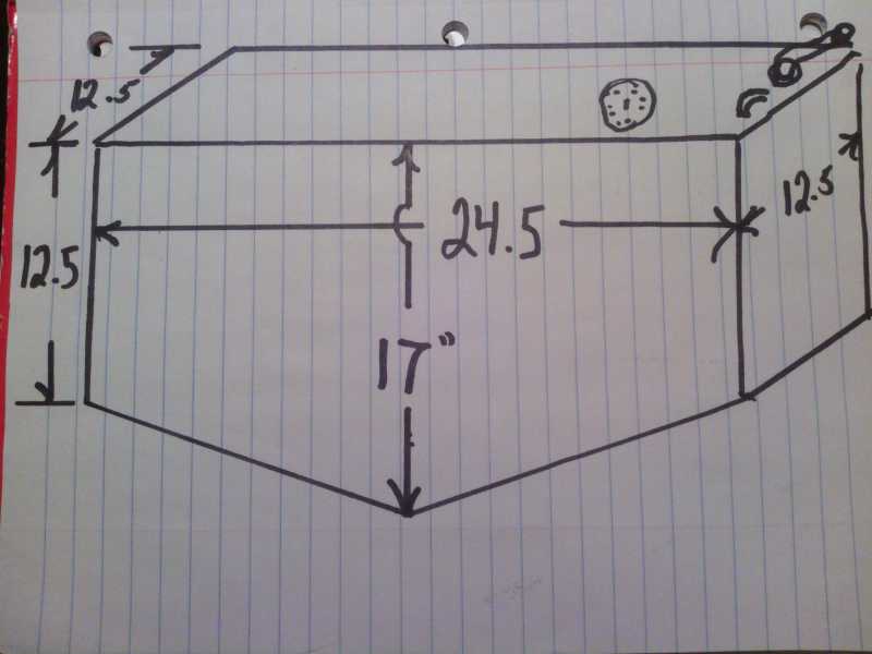

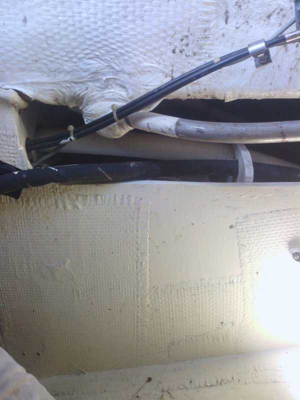

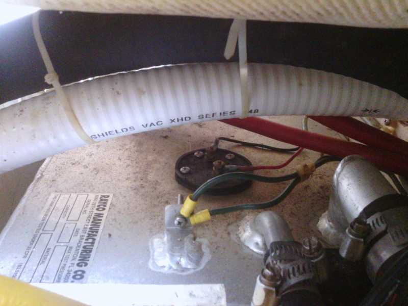

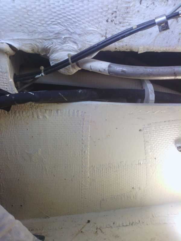

I have replaced the fuel tank on Windependent 31#112 It will not come out in one piece. I cut the stringer to allow the tank into the port side locker, I put a piece of dry ice in the tank for a few hours to displace the oxygen. I know diesel is not all that flammable Call me a worry wart. With a saws all I cut the tank in two and removed. I had a new tank fabricated in a shop in Bradenton Fl. this tank was several inches narrower , allowing it to slide in with out a hitch. This reduced the tank to 20 gal. from the factory 25gal. Have not run out of fuel yet. If I had it to do over again I would have had a clean out port installed on the new tank. If any questions I will answer any questions if I can .This size will tank will fit right into the locker, my vessel is a center board model , having an additional pipe for the pennant. A little more of a squeeze but as you can see doable. Re-glass the stringer paint and off you go.

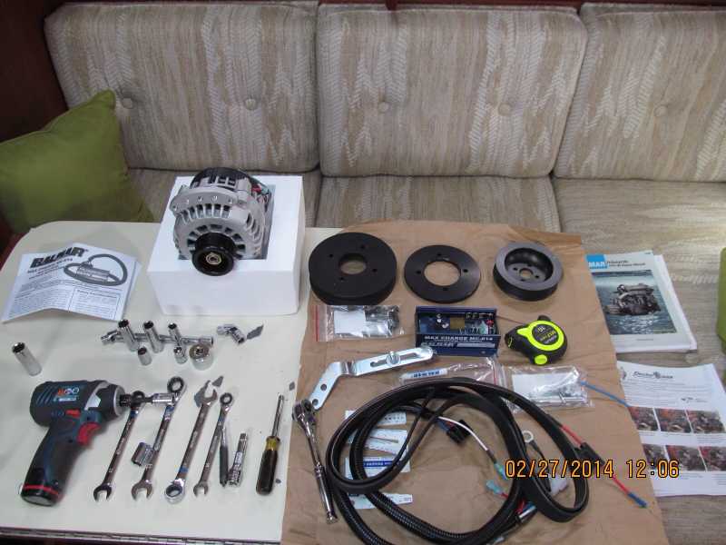

Thank you, I will do that. By the way I am upgrading my alternator to a high output alternator with serpentine belt. I will attempt to do a decent outline of that and then link in a great how-to article on that.

Rayco manufacturing co , 6060 28 st. E Bradenton Fl 34203 ( 941-751-3177) Cut up the old one and measure what will fit back in . In the case of 31 # 112 a tank about 3 in. narrower 5 gal. less. Aluminum, tank went right back with very little retro fitting. The price varies by size, with a new fuel level sender it was well worth it.
A very doable job. Good luck.
