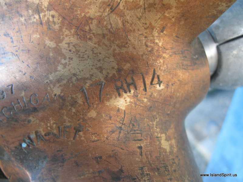

I just checked my photos and we have on out IP35-165, 1994, 3JH2E 38 HP engine:
Fixed Three Bladed Michigan Wheel 17" x 14" RH prop
That is 17" diameter with a 14" pitch, right hand rotation when viewed from the stern
The shaft provides enough room aft of the stern tune for a egg shape zinc.
I feel as if this prop is just a bit over pitched as I can power up to 3,000 RPMs
Other IP 35 owners have re-pitched to 13.5" What all this means is that in one revolution the prop will move forward the pitch. So a higher number is more pitch more bight, but harder to spin up to full speed as well. There has been lots of discussions over the years of prop pitch and it remains a challenge to match it all up to each boat due to loading and cruising variations.
We have run this IP35 now 15,000 miles with this prop and I am happy with the 14 pitch. Yes, maybe 13.5 would be better, but I can power at 2700 RPMS all day long and my speed is fine at 6.0 - 6.5 avg. I can push up to 7 knots at 3000 rpms but this boat and this motor will run forever at 2500-2700 rpms very well.

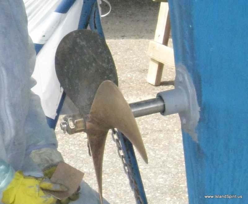

here are some photos:
HERE IS A PHOTO ESSAY OF WHEN I PULLED THIS ALL APART
ipphotos.com/view_ad.asp?Ad_ID=361
HERE IS A COOL IDEA.....HOW TO PULL THE CUTLASS WITHOUT PULLING THE STERN TUBE
ipphotos.com/view_ad.asp?Ad_ID=1510

Great photos, thank you. Did the stern tube come off without dropping the rudder? I'm wondering about the clearance at the aft end of the shaft. I'll try the screw trick to get the cutless bearing out.
It looks like you have more shaft exposed with the fixed prop than with the old Prowell prop. It looks similar to mine with my fixed-blade prop in place (I really need to get some photos). I had not thought of the difference in clearance with a different prop--yet another reason to leave the shaft length alone, in case I want to change props in the future.
I'll get the prop off and do some clean-up in the garage on a cold, snowy day this winter to confirm my current prop size--the cutless bearing is the first order of business. Once I get that done, I can decide whether to keep the existing prop, re-pitch it, or go with a different prop. I started exploring prop options based on the survey comment that I was over-propped, which in turn was based on only being able to reach 65% of WOT when in gear. I am intrigued by your comment that other IP owners have re-pitched to 13.5"--it sounds like it's not unusual to be a bit over-pitched. I am still interested in comments on the Campbell Sailer prop, which has airfoil-shaped blades with a thick chord for better efficiency (the design appeals to my engineering side, I can't help it). They're a little pricey, but might be worth it if I would otherwise be re-pitching my existing prop anyway. Do you know anyone who has one of these?
