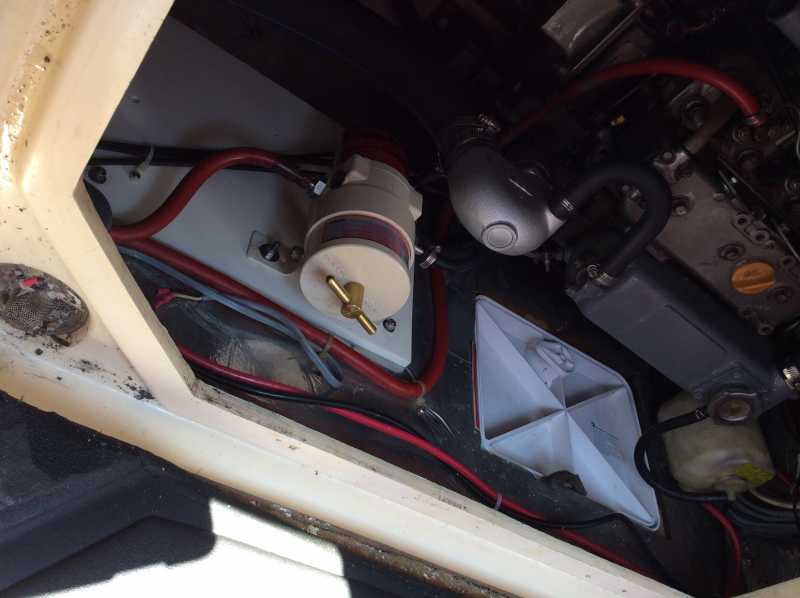

12 years 5 months ago - 12 years 5 months ago #2765 by Emergpa1
Replied by Emergpa1 on topic Re: Looks like a setback
Glory wrote: I checked the boat yesterday and there was a small puddle under the filter. I used a paper towel to check the sides, nothing. (the red dye in off-road diesel really shows up on a white paper towel) It appears that the fuel is coming from petcock. According to the Dahl website, that petcock is a non-marine item that screws into an adapter that screws into the fuel bowl. I see additional possibilities for leaks there. The obvious answer is to replace the filter however we are already three weeks behind on the lift in prep and it looks like the weather window for working on the boat closed with rain and snow predicted through Saturday.
here's a wish for pictures of your projects so I would have a better idea of your rig.
You are sure the leak is not coming from the feul line you loosened and then retightened? Probably not but giving it a little extra turn with a wrench might not be a bad idea just to be sure it ceded well or back it out and do it again but that would let air do your system which sounds like a pain in the butt.
Have you run the engine yet? I wonder if you're bleeding was successful. On my 3GM, there is more than one screw that you have to loosen to bleed appropriately. One is a rather sneaky spot forward of the bleed screw over the engine mounted feel filter. Although I had the engine manual, it did not make it plain, I was fortunate enough to have someone familiar with the engine to show me the sneaky spot. If you have the same engine as I do let me know and I will include a picture of the other bleed screw between the fuel filter bleed screw and the fuel injectors.
I am not sure about the layout of a 27, and I do not have good will access here off of Cumberland Island to pick it up, but are you able to cut an access to the side of your engine through your quarter birth? It is very easy and u will see the inside of my opening hatch next to the fuel filter below.
Do not forget to order the appropriate fittings for the Racore fuel filter when you order it. Do not hesitate to call the customer rep if needed. They might helpful. I did not call customer rep so cannot attest to that.

12 years 5 months ago #2767 by Glory
Replied by Glory on topic Re: Looks like a setback
The 27 is opposite the photo above in that the fuel filter is mounted on the portside of the compartment. I do like the idea of another access hatch though, I will need to take some measurements to see if that is actually an option. As I recall the 27 q-berth does not have the depth, I don't know if a large enough access could be made to be worth the effort. A measuring tape will answer that question though. The exhaust system is also on that side of the compartment so I would have to measure and see how much is blocked.
To answer your other questions, yes, I did check that fuel line and it is tight, the top and sides of the filter are dry so that leaves only the petcock. What I was thinking is that in the process of opening and closing the petcock I may have also loosened it by turning in the threads? It was a difficult little lever to move. On our 2GM I am not aware of any other bleed screws in the fuel system, my manuals are down on the boat so I can check those on Friday as well.
