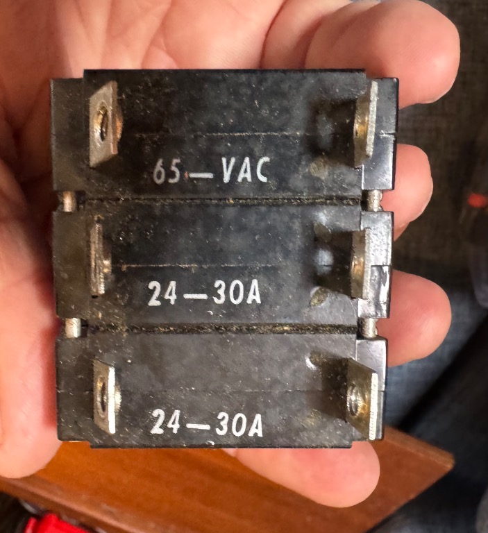

1 year 6 months ago #7548 by alston59
I’m looking for a replacement AC Main circuit breaker for my IPY 1991 38 cutter. Can’t seem to find this. Any ideas on where to buy this. See photos
1 year 6 months ago #7549 by MacMcDermid
Reach out to PanelTronics.com they made the circuit breaker panels. I was able to get backlighting, breakers and led lights from them by providing the model and year of my boat.
Mac McDermid "Hamba Kahle" 1997 IP37.
