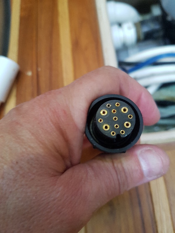

9 years 3 months ago #5637 by islanddreamer
What cable is this? was created by islanddreamer
Which cable is this? Comes from the mast and back to the binnicle.
9 years 3 months ago #5639 by hayden
Replied by hayden on topic What cable is this?
Blair:
That is the Raymarine Radar antenna cable that would come from the mast mounted antenna down the mast to the helm to the Raymarine chartplotter. I know, I installed one in 2002 and just removed it in 2016.

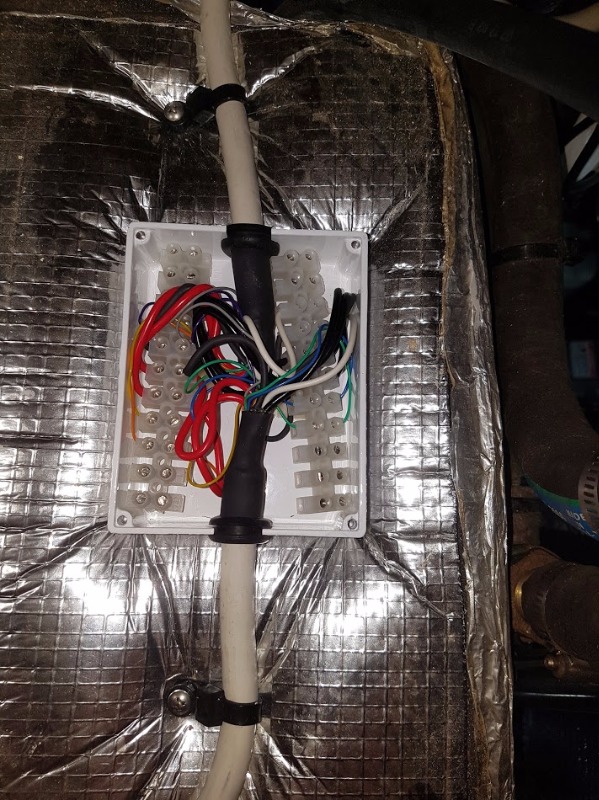

I followed the cable to this junction box.
Looking at Raymarine's website, it looks like their cables all have connectors on both ends but IP used a junction box for this connection. Was yours similar to this?
Cheers
Blair
9 years 3 months ago #5641 by hayden
Yes, we had a junction box just like that at the base of the mast. It's needed so you can pull the mast. Some installers also put one at the bottom of the helm. Eitherway, these mast mounted radar antennas require this.

Our junction box is under the binnacle.
So, would I need to cut the female end off of the cable in order to connect to the junction box? Why wouldn't they have just used the standard connectors?

We nicked the old cable while doing some other repairs so have to replace it. The first connector I showed is on the cable that comes out of the mast. There's quite a lengthy cable in a spool from the mast to that connector.
The cable then runs under the floor up behind the small spice cabinet by the sink in the galley to the junction box shown in the second photo. I'm looking to replace that cable run. I need a male end to mate up under the mast and bare wires to the junction box under the binnacle.

OK, now I understand. Here is what I would do. Since you have extra cable in a spool under the mast, why not just pull extra and make another junction box where you nicked the cable run. There is nothing special about junction boxes, they are there to ease install. So, go to the nick wire area, pull some extra wire towards that, cut it and six your nick. That will work. Otherwise you will need to find this cable used off Ebay because it looks like an old analog Raymarine Radar antenna cable. I would focus on fixing the nick by simply cutting the wire and stripping the wires and but connect them together then heat shrink the joint. Done.

Thanks for all of your help! I was able to find a cable on EBay which didn't cost much more than the junction box. Going with this option is a bit easier in the long run.
