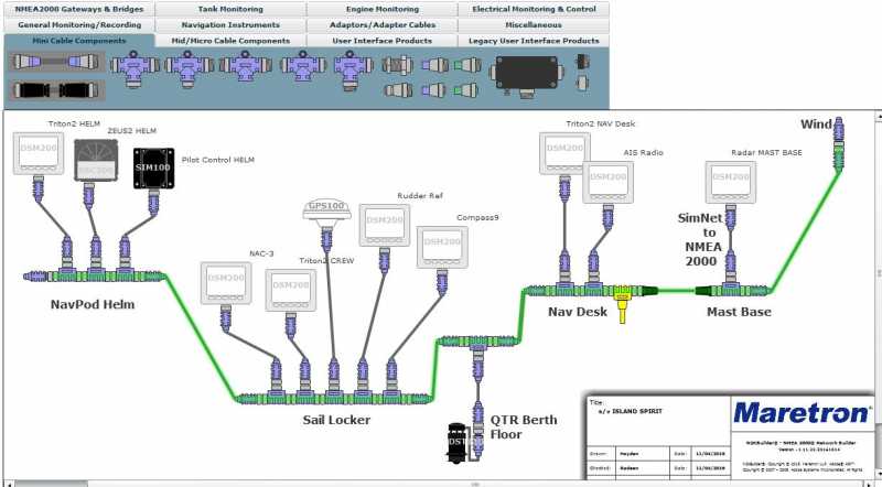

This is the new B&G network Radeen and I built this week on Island Spirit. All cables are run and connected except two arriving Monday. We need to connect this to the 12 volt power and then install all the NavPod gear at the helm. We found this free software for designing NMEA 2000 networks, it is very cool. Next week, we launch on Monday and then move aboard for Mack Sails mast work and Radar install. We are ahead of schedule. www.maretron.com/products/N2KBuilder.php
