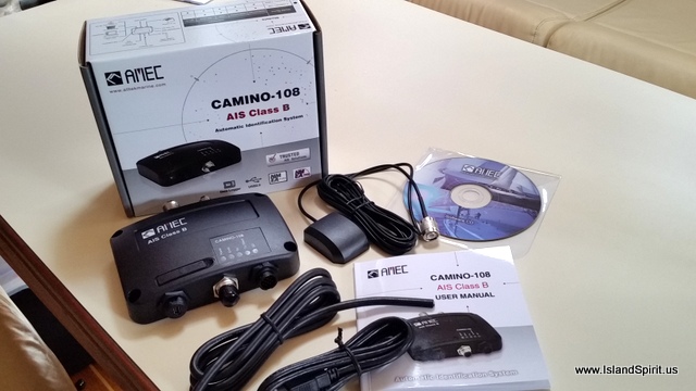

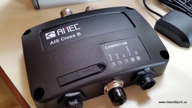

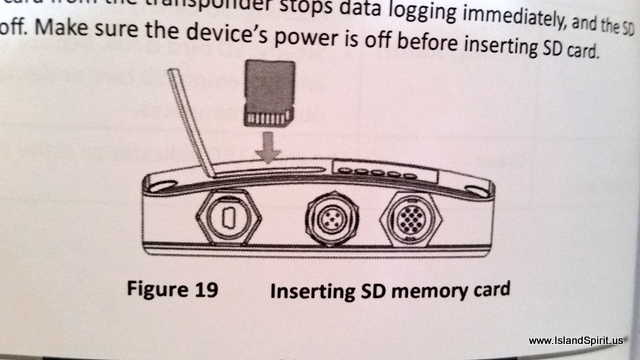

My AIS AMEC CAMINO arrived here in Vero Beach, Fl. This unit looks great. It will be very easy to set up. take a look a these photos, and I also discovered the unit has an SD card slot which will record all data into a text file. That should be interesting for logging trips. I will report more once I install this unit and replace my SR 161 AIS radio.
Here are some photos.
The contents
The AIS Radio

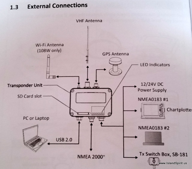

The install diagram
The NMEA 2000 and 183 output

Ho cool is this???

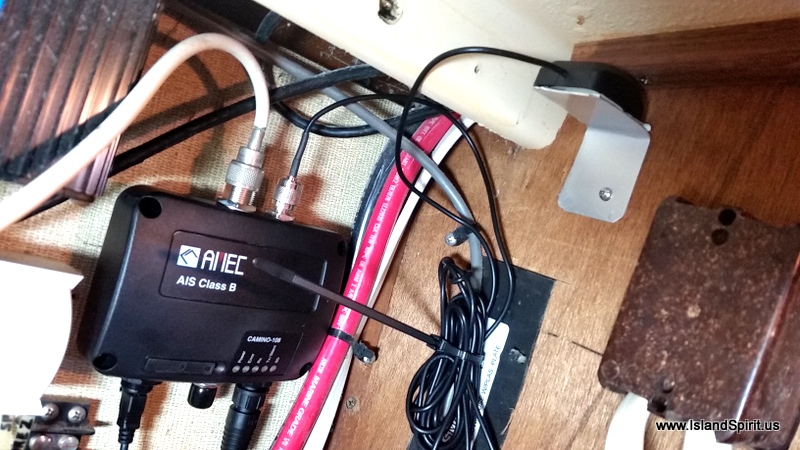

This was the easiest install ever, since I was simply removing one AIS radio and installing this one. One change I made was that I bought the $10 GPS puck and I installed this under the deck on a simple little L bracket with the puck directly under the deck. This way, all I had to connect was the 12 volt power and this GPS and plug in the USB cable. Then on the laptop, I installed the USB drive, always a challenge to get it to talk to the laptop, but once configured, this unit light up and is transmitting well.
What I like about this unit, besides the $450 price (Annapolis show special) is the fact that it will output NMEA 183 (two streams) and NMEA 2000, and USB cable. So right now, I can add this into my USB feed and present the targets on the OpenCPN nav software I use at the nav desk just for AIS. Then when I upgrade my helm navigation system to one that will read AIS, then I can feed this output via NMEA 183 or NMEA 2000 to the new helm station.
Overall, this is a great unit, it works well, and it was easy to install. It took me about 30 minutes to install it, and about 30 minutes to configure the USB port.

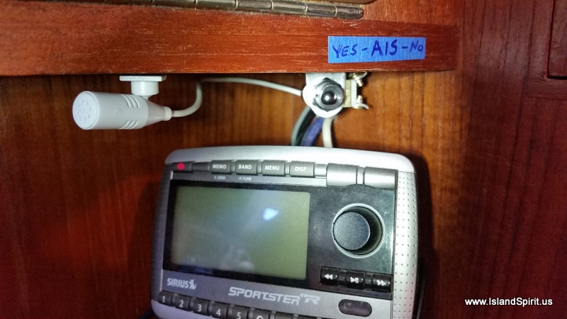

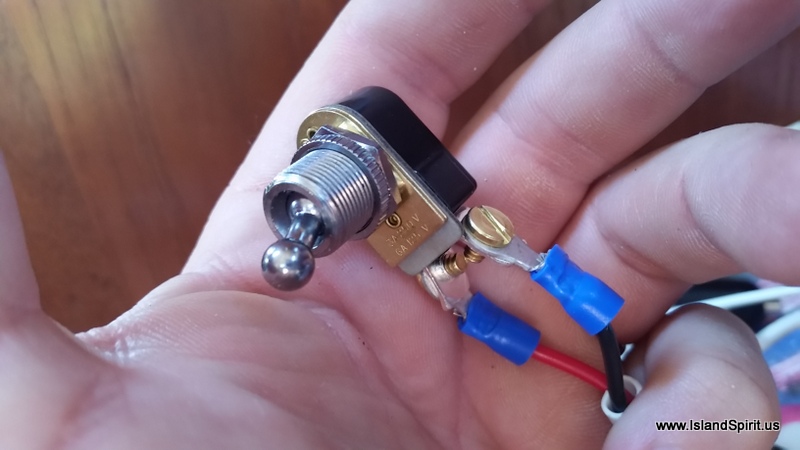

More on my AIS CAMINO, I now added an on off Silent/Transmit switch
This AIS Camino has a connection for a simple on off switch that will shut down the transmit of the AIS but still leave the receive part on. This is called the TX/Silent connection for transmit vs silent mode. I made a simple bracket and added a small toggle switch and placed this under the instrument panel on our IP 35. Again, I am very impressed with this unit and it seems like a very fair deal and this AIS until will talk to any NMEA 183 or NMEA 2000 gear.
Here are a few more photos:
A simple switch
My simple $10 GPS added under the deck on a simple bracket

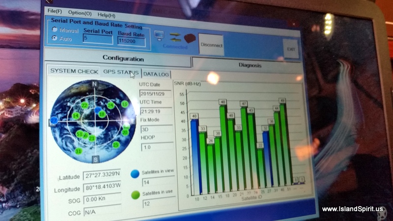

The GPS signal strength is great
Where I added the Tx / Silent switch for AIS

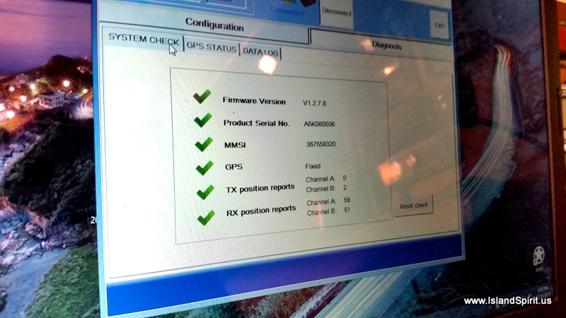

The Camino software diagnostics lets you know you are transmitting and all is working

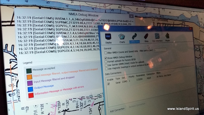

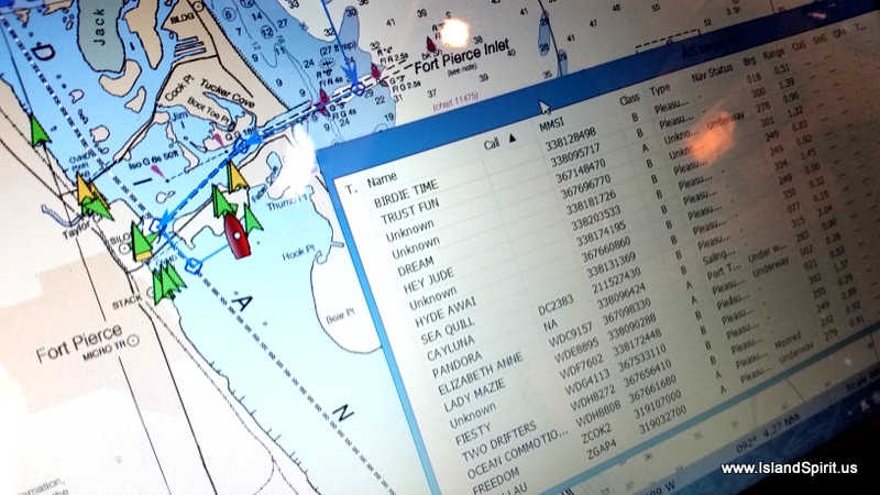

I use OpenCPN computer nav software, here you can see the NMEA steam
Proof of the AIS working with targets on the OpenCPN nav screen
