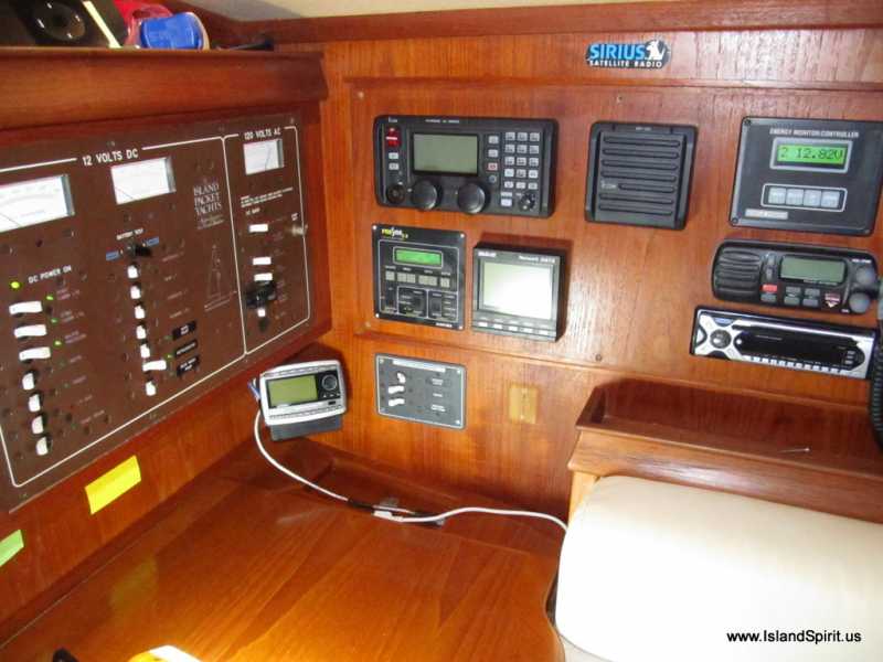

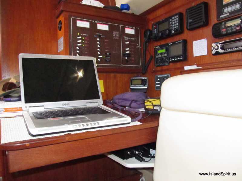

The Head unit and speaker are in the Panel
The Transceiver is on a custom Shelf under the NAV Desk
