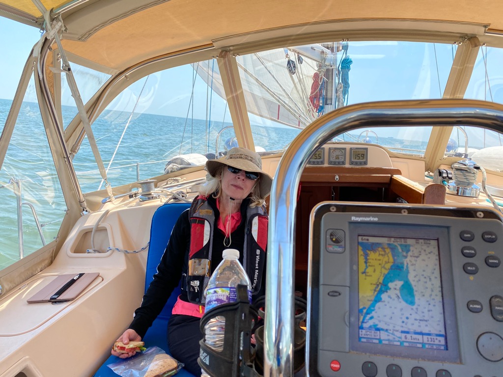

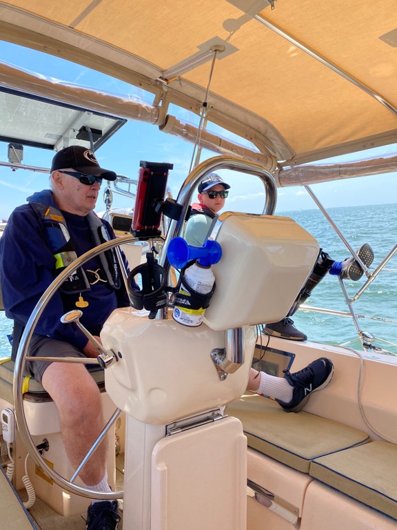

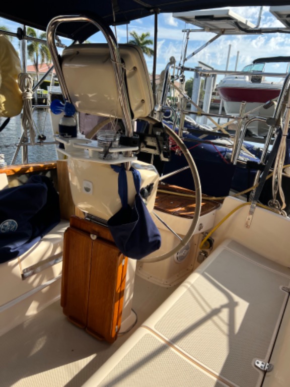

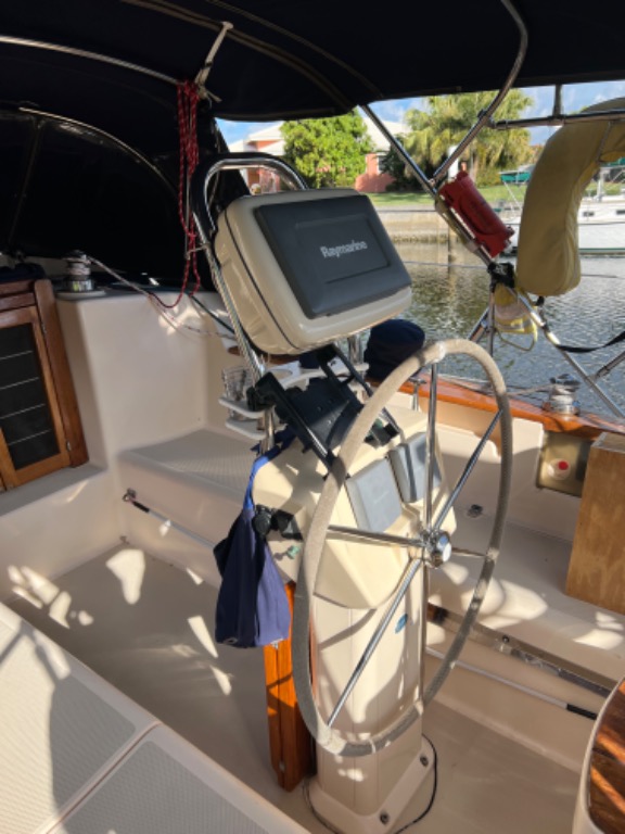

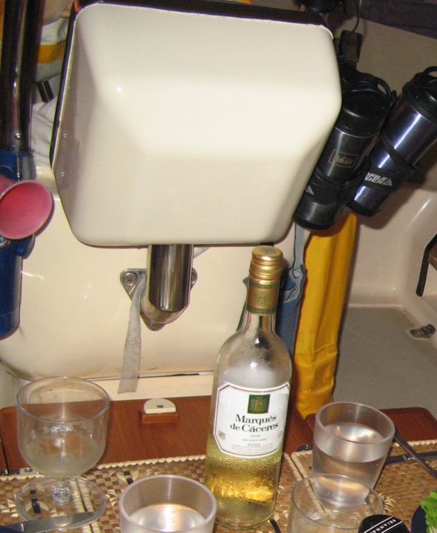

We had experienced the issues of MFDs blocking visibility when sailing with friends on their boats including an IP380. Our solution was worked out with the commissioning yard for our 370 with the Whitlock helm. The key was moving the MFD to the forward side of the grab bar and required an inexpensive custom stainless part fabricated by the yard. The yard manager told me a few years later he had sold many more of the solution. I know others have copied it after seeing our boat. These are the best pictures  could quickly fine and the looking forward was taken by me while seated.
