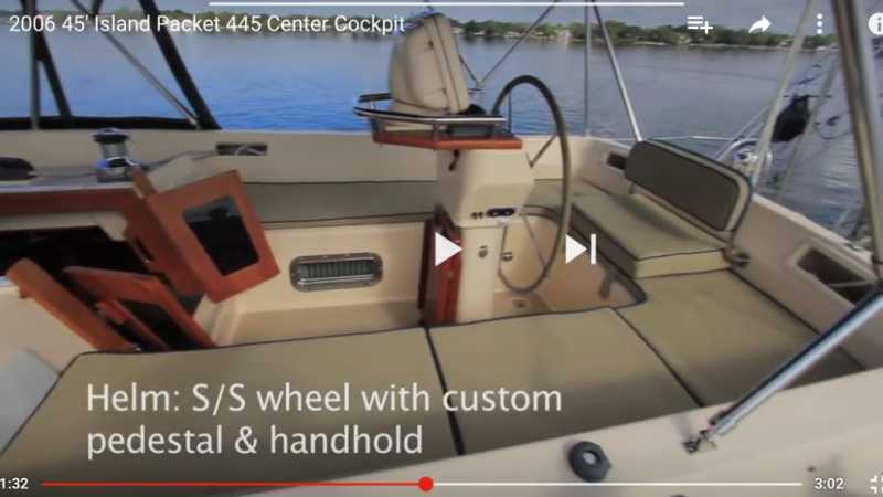

I am upgrading my electronics on my IP 445 and liked how this Navpod was mounted. The attached photo is a screenshot from the sales You Tube video. This is on an 2006 IP 445 which at the time was named "Gail C" that was for sale in 2012.
Appreciate any help or information on contacting the original owner to see where this was done. If anybody else has some good examples of pedestals/handholds on IPs, please share.
Appreciate the help, Thanks

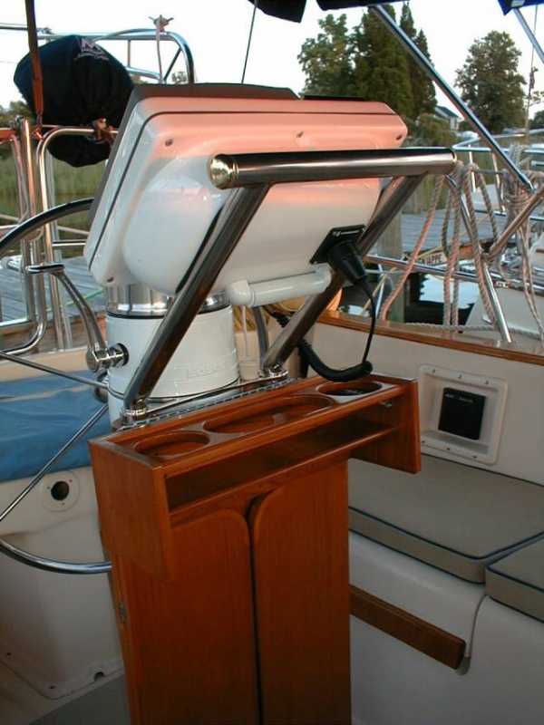

We have the old IP 35 and I ripped out the old helm and installed a new Edson CDi helm, then my welder made our custom helm. You can see photos of that here in my commissioning archive from 2002.
fhayden.com/rockhallfleet/islandspirit/edson_helm.htm
Bottom line, you can get anything made.
