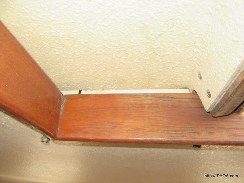

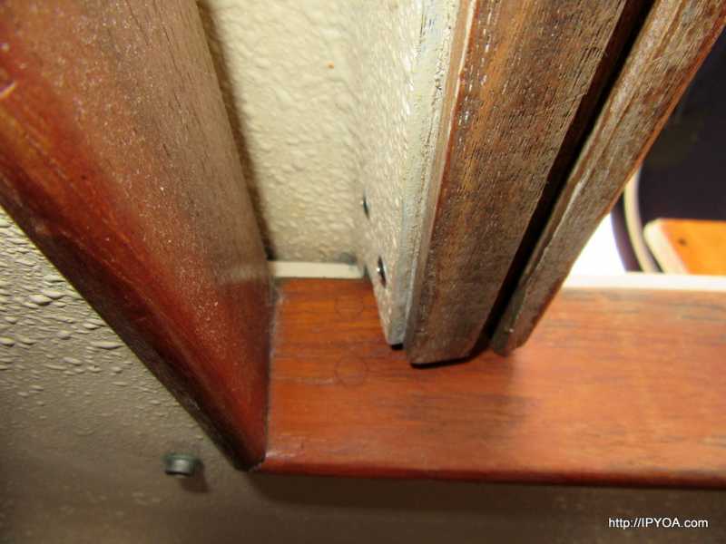

10 years 9 months ago - 10 years 9 months ago #4579 by hayden
Replied by hayden on topic Companionway Hatch Rails
Here are some photos to show you how the hatch does not slide back the entire way, so you can easily mark it from below and use a small pointed hand saw or fine saw and make the cute. Slide the hatch forward after marking to make your cut.
#1: Slide the hatch back to the stop and mark it
#2. Slide the hatch forward and use a small saw and cut it
#3. From the top, unscrew the old and screw down a new slide.
You can buy the slide material from the factory or you could use starboard and cut your own strip.

9 years 3 months ago #5669 by hayden
Charlie
If you slide the hatch open, it stops short of all the way back. Now, go below, look up and you will see the hatch slide aft of the lid but forward of the deck. This is where you cut the slide. Use any pointed hand saw you can get into this space.
Once cut, now unscrew the part you can see aft of the hatch. Use this as a template, make your new ones. Slide new ones under hatch up against your cut and screw it down.
The hatcheck will not slide over your cut. Remember, the hatch was slid open to the stop and then you cut in between, and behind the lid.

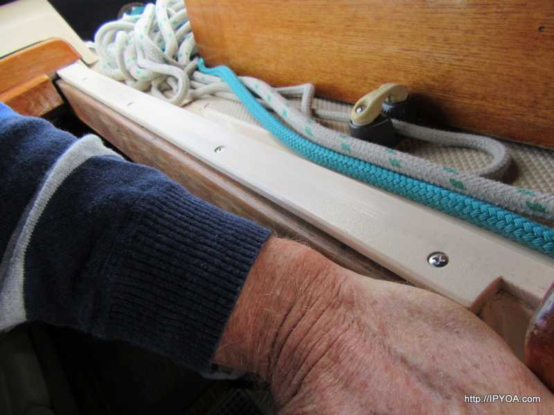

8 years 8 months ago #5980 by mcduck52
Replied by mcduck52 on topic Companionway Hatch Rails
We just replaced ours with 3/8" starboard cut into 1 3/4" strips. We routered the edges, then ran the strips through a planer to slick one side.
The strips were cut to length (we did not remove the hatch cover; but just cut the old strips back as far as possible) then countersunk and fastened into place with a silicone seal. Neat and easy.
