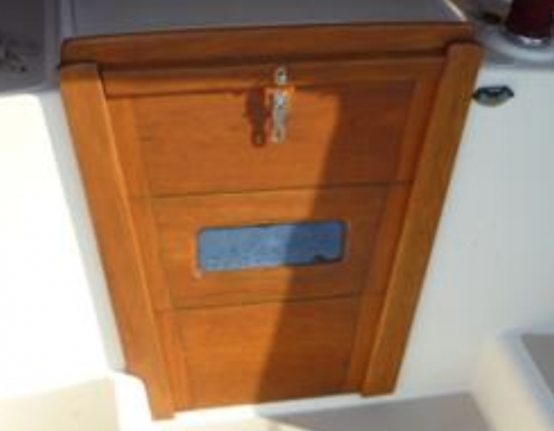

12 years 5 months ago #2813 by Emergpa1
Replied by Emergpa1 on topic Re: rain thru main hatch
here is a photo i found, and can see that the trim on the hatch slides past the top of the topmost hatch board, to become flush with the side trim. You may can see that there is a small spacer on the lock hasp that shims the hasp out, so i would guess that your hatch should slid about a 3/4 of an inch past the top of your hatch board. if it is not, the you should not be able to lock it.

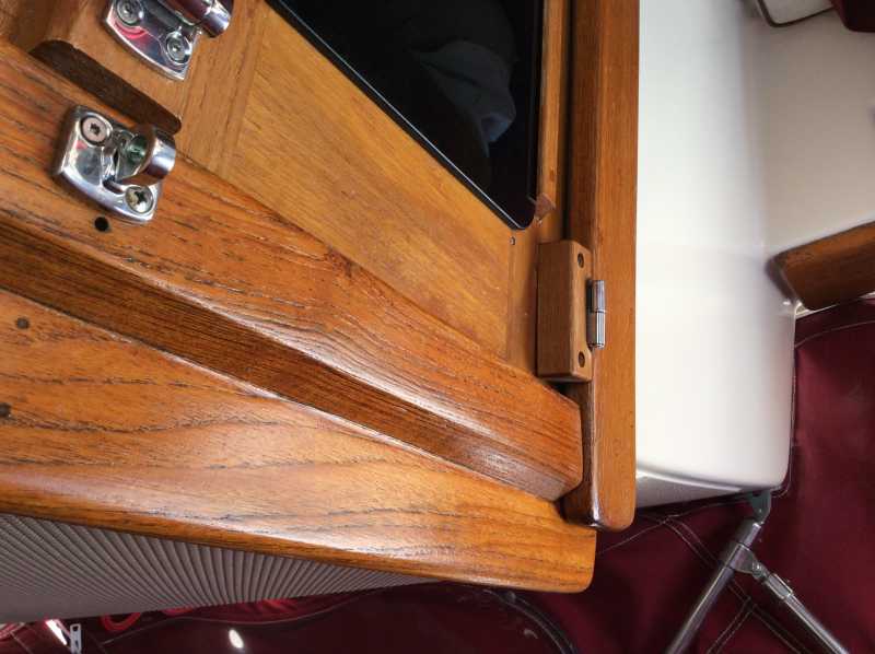

12 years 5 months ago #2820 by Emergpa1
Here is what I have. Note the side trim.
[attachment:1]image.jpg[/attachment]

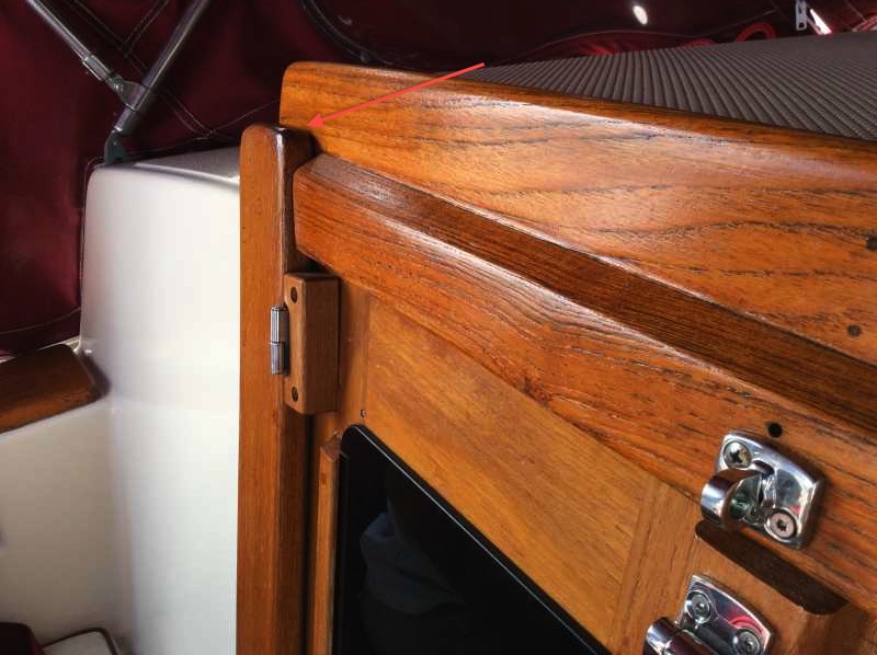

12 years 5 months ago - 12 years 5 months ago #2824 by cat30
Replied by cat30 on topic Re: rain thru main hatch
arrow is pointing to space behind side and in front of slider that has about 1/8 to 1/4 space that allows rain inside.
i'm able to put a lock in the hasp.

12 years 5 months ago #2825 by Emergpa1
cat30 wrote: arrow is pointing to space behind side and in front of slider that has about 1/8 to 1/4 space that allows rain inside.
Yes, mine is that way too. Theoretically the water should run down the channel just behind the hatch boards then out from underneath the hatch board to the exterior. So it seems that you're sliding hatch is functioning properly. I think what you'll find is that in a hard rainstorm with the wind blowing from the stern of the boat, you are going to get some leakage around those areas since, technically, it is not sealed but simply blocked with hatch boards. You will have the opportunity to be on the boat during some hard rains and that is the best time to figure out what leaks inappropriately and what does not. That area is designed to tolerate water. That is why it is has a molded floor instead of holly and teak with a drain to the bilge.
