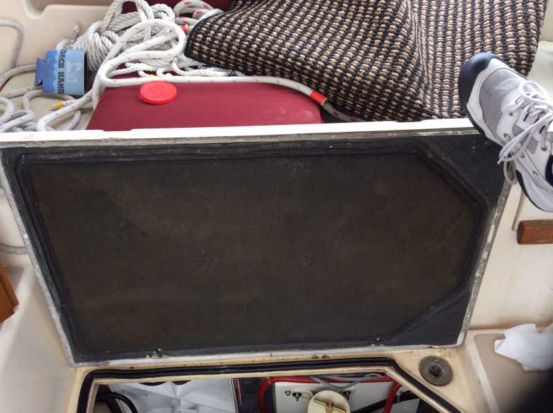

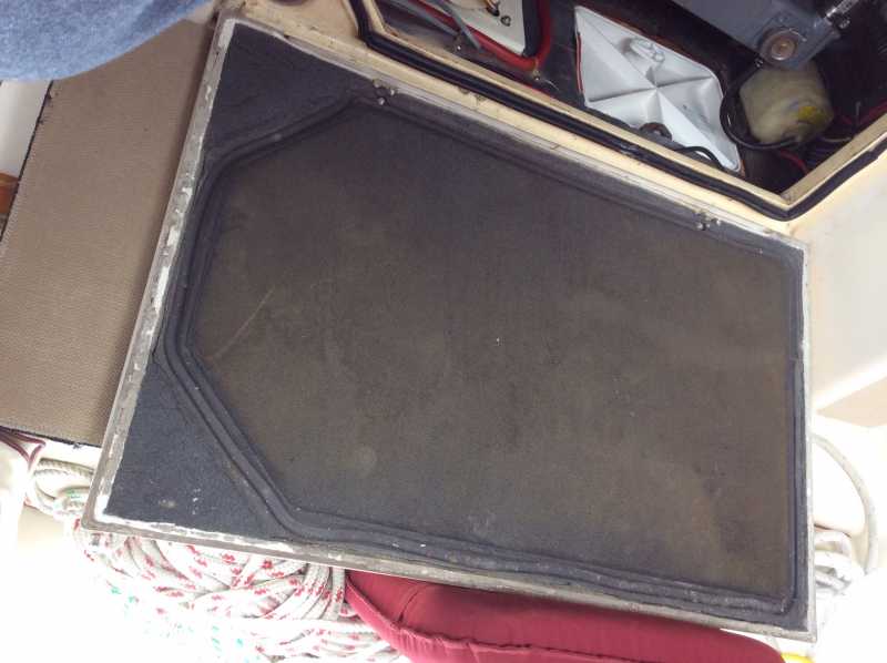

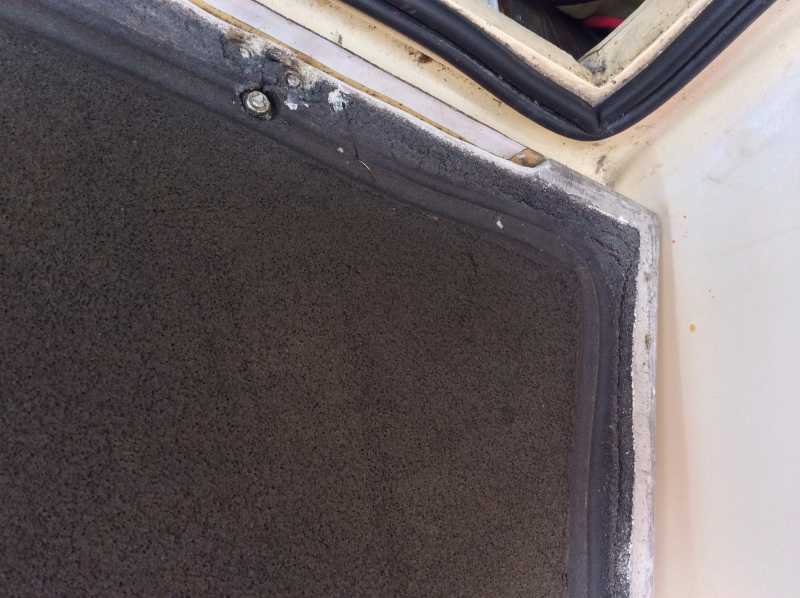

What is the material used underneath the hatch to the engine compartment in the cockpit of our island packets? Mine is old and is lost all flexibility and is allowing water to leak into the engine compartment. I have attached a couple of photos. Any help appreciated. Thanks!

I found a product at the local industrial heating and air-conditioning suppliers. It is called arma flex. It seems to work very well. I wash the boat and had a clogged drain and not allow water around the foam seal the engine compartment underneath the cockpit sole. So far I am very happy with it. Hopefully I can load a couple of photos below.

Your problem may be that the hatch, and the foam insulation, are riding too low and covering the scupper. I found this was the case on my IP 27, and placing a thin piece of wood in a position to lift the hatch around 1/2 inch. This solved it; no more water getting into the engine compartment.
New insulation will provide a longer term solution.
9 years 7 months ago #5513 by Vandergraaff
After much searching, it seems that the closest replacement foam is closed cell IAFC05N distributed by Soundown Corp. It is Ensolite, made by Armacell, but I could not determine exactly which type. $40 included shipping.
www.armacell.us/categories/ensolite/
In my crude flame test, it self-extinguished just like an old sample of the existing foam. It seems to be stiffer (smaller cells) but I think it will do the jobs of sealing the rim of the hatch, and some noise suppression. They say to attach it using 3M Super 77 spray adhesive.
