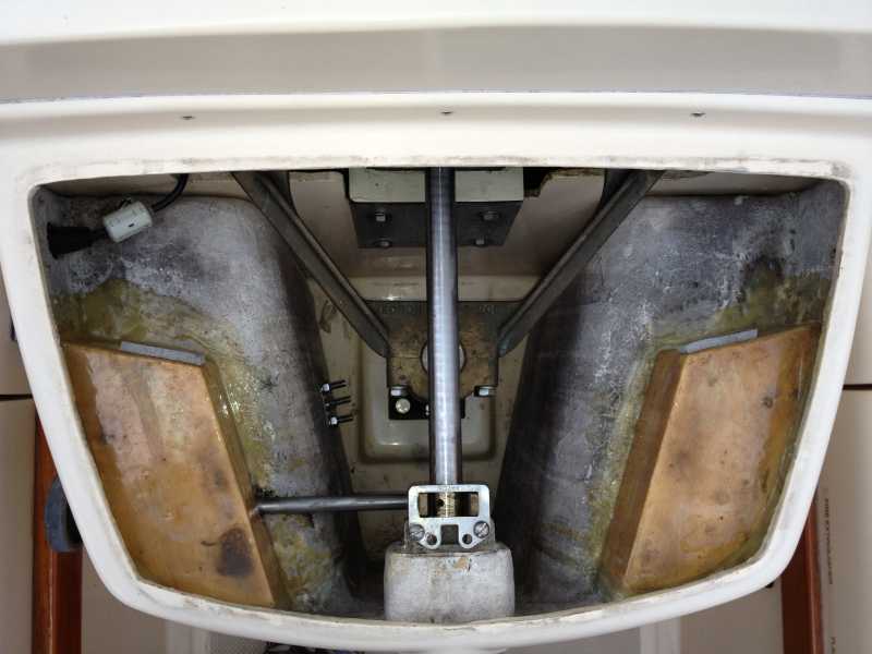

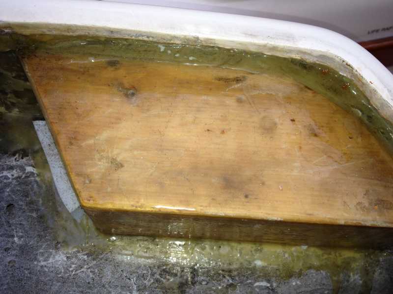

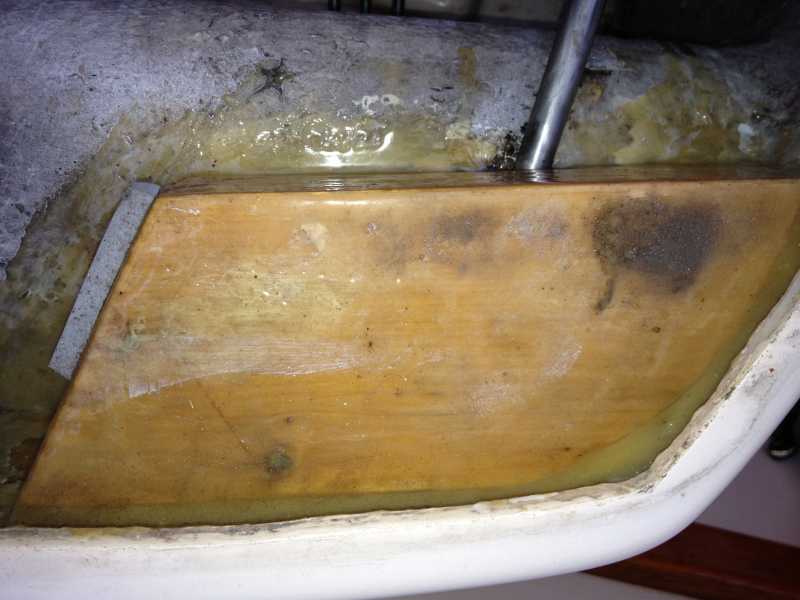

Same thing happened to me. I made new wood blocks, using the old ones (or what was left of them) as templates, epoxied them together, then epoxied them into the helm seat. This was my first effort at using West System expoxy, and it's a perfect place to practice: simple job, good access, and no worry if there are drips and it doesn't look perfect. Instead of re-using the aluminum plates, which were pitted with corrosion, I used thickened epoxy at the ends and added some self stick foam (extra weatherstripping from my engine compartment lid) where the quadrant hits the block. Photos attached.
Michael Luskin
"Turtleheart" IP27-146
Scarsdale,NY
Top View
Starboard Block (with groove for wheel brake shaft)
Port Block
