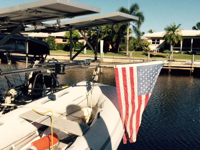

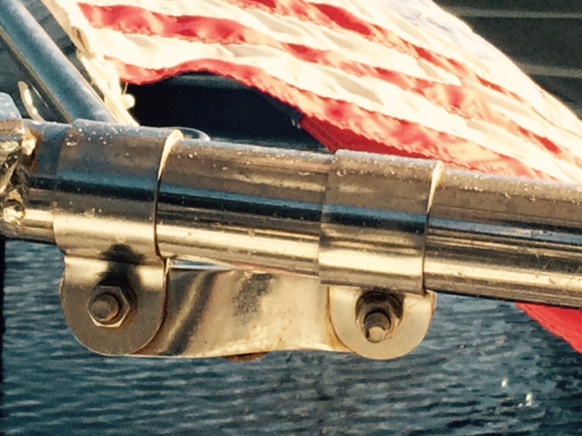

We have a flag pole bracket that mounts on a horizontal stainless tube that keeps the davits spread. The stainless tube sits well above the dingy. The flagpole is about 3 feet long and extends aft so the flag hangs down nicely aft of the dinghy. It's a clean setup. Just watch for nearby pilings when backing into a slip. :whistle:

That sounds perfect. Do you have a picture of that configuration?
10 years 7 months ago #4426 by Carl D
Here are some pics of our flag mount. Noe the bracket is somewhat bent as the result of a piling that refused to move out of the way as I was backing up. Stupid piling. ;)
