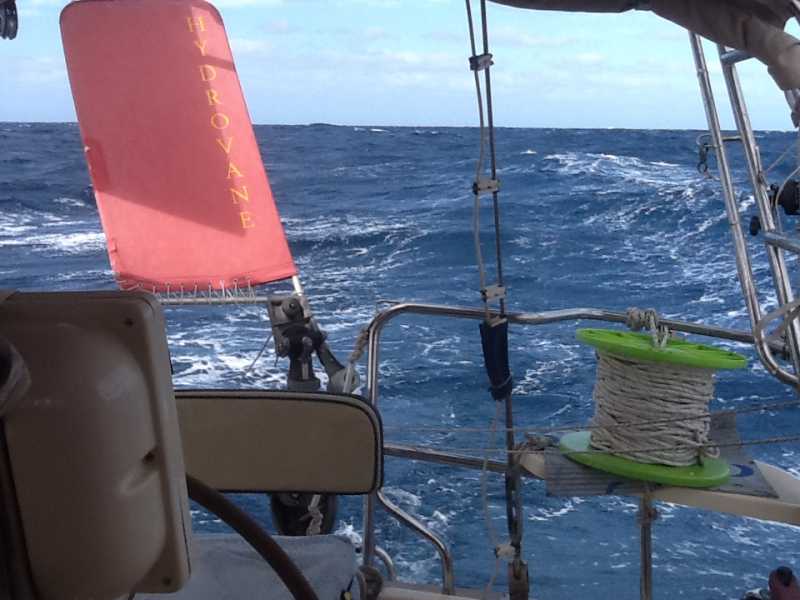

10 years 8 months ago - 10 years 8 months ago #4645 by Lexxy
Hayden thought I could help here. We had a Hydrovane on a 380. The flat stern will make it easier to install and a 38 is narrower than our boat so that will be better. Our width meant we had to not use the whole sails cuz it sucked us a bit too much to weather but once we took in about 10% we held a course just fine. You might find that too but not as much since IPs are beamy. We liked a hydrovane cuz it was a spare rudder button I'm sure others will work fine. We liked the way we locked the wheel and controlled the vane with a thin but strong line.....never broke. The cane held in confused seas in the Atlantic when other boats had to hand steer cuz their auto helms wouldn't hold.
