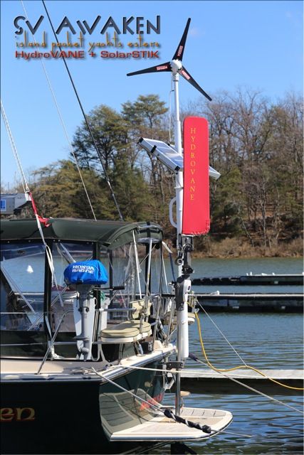

Do any other owners have windvane thoughts or comments? I am particularly interested in installations through the swim platforms. A center line installation would obscure the stern pulpit entry but Will Curry from Hydrovane assures me the unit works fine installed off center. I believe him, but I like aesthetic balance. Attached is a picture of a Hydrovane on an Estero with a platform. This would work, and the steps are elegant.

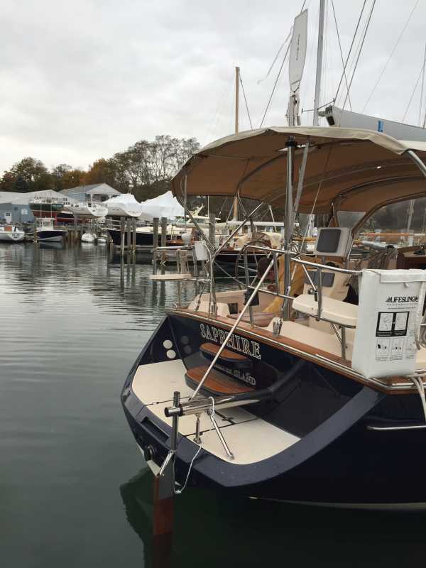

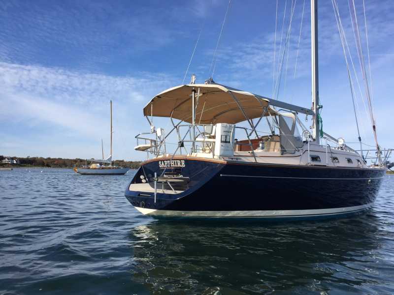

Hi Jeffrey,
I had the Capehorn steering gear installed in the fall on Sapphire my 370. It allows off center installation as well as the ability to be positioned high above a Bimini etc. I met Yves Gélinas who created the vane through his film that I helped restore and was blown away (no pun intended) by the simplicity and elegance of the design. Proven on too many boats to mention including Joshua for a awhile before it was commissioned into a museum.
