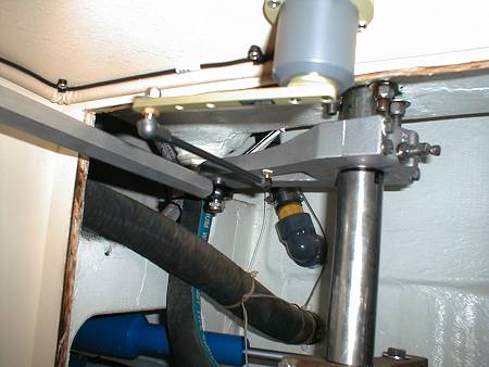

I'm in the process of installing a Raymarine Type 1 linear unit and would like to know if the tiller arm needs to be bolted through the rudder post or will it stay put by compression. Drilling the post looks like a difficult job.Thanks

Drilling the rudder post is not that difficult.. Get the right tools.
Get some quality -sharp- drill bits, from a machine shop or industrial supplier- not the cheaper Walmart variety.cheap bits will dull imeadiately.. Quality bits will make all the difference.
You probably don't have to drill the post all the way thru....
Are there holes for set screws in your tiller arm? If they are not there then you should put them in. To do that, temporarily install the tiller arm, then mark for the set screw holes.
Remove the tiller arm and - drill them thru on a drill press before u install the arm permenently. Or have a machine shop drill and thread the holes in the arm for set screws would be a good idea. While at the machine shop talk to the machinist about the set screws and quality bits... Then with the right tools you can drill the rudder post yourself. To do that, armed with quality bits, then
Re install the arm on the post
Tighten the set screws to mark the rudder post, remove the arm, then drill shallow holes -1/4" deep where the set screws marked the post.
With these two holes the set screws will seat and not slip around on the rudder post re install the arm,
Tighten in the set screws and you r done! Easy...

Chuck:
I would not drill all the way through the rudder post. I would drill a dimple dent where you can then bolt a set screw into the dent. This is what we did. If you look at our commissioning photos here
fhayden.com/rockhallfleet/islandspirit/b_&_g_pilot.htm
you will see this bolt at the end of the essay.
