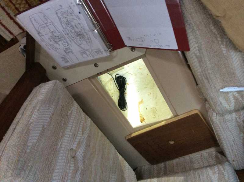

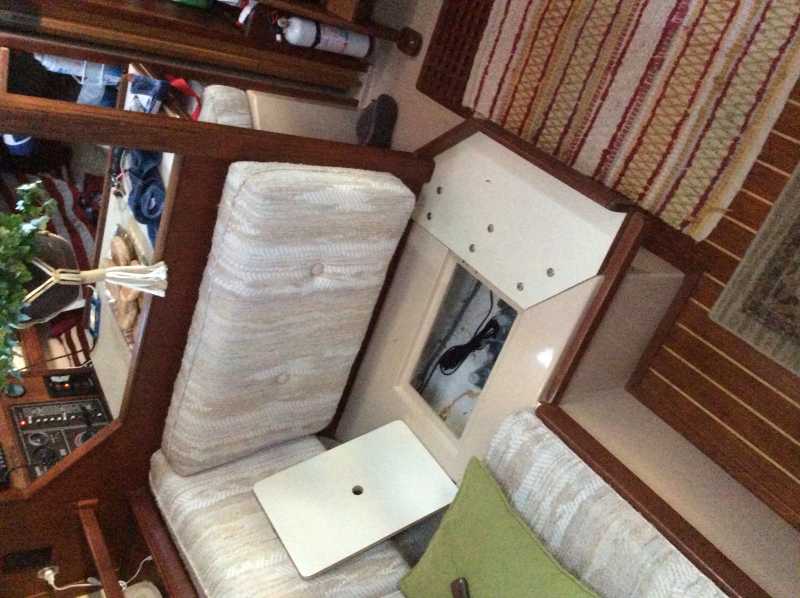

Here is what I have. Note that I have removed the "Y" valve and plumbing as well as an old through hull for a sounder.
What did you find out about the Bobstay crack? That worries me.
I measure the locker as follows; opening is 9.5" by 15.5", the height at the opening runs 13.5" to 11" width is 22" and length is at least 36" .
