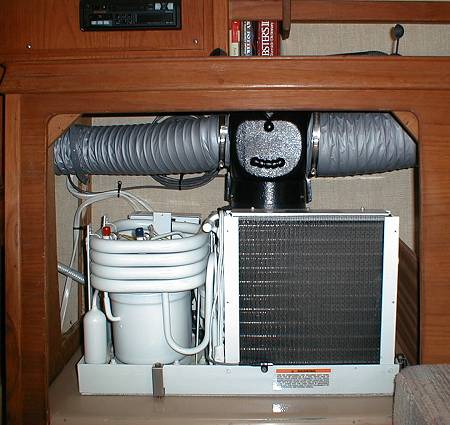

12 years 10 months ago #2169 by hayden
Replied by hayden on topic Re: Air Conditioning for IP35
Daniel
We installed a 16 BTU AC unit on our IP35-165 in 2002, and we have it installed port side just forward of the nav desk. This gives access to the aft cabin, salon, head and forward cabin via the shower. If I were doing it again, I would do exactly the same way on an IP35. The return air is under the nav desk. The condensation drain is contained and connected into a T in the bilge where the shower drain runs. The duct into the V is via the bottom side of the head shelf, then into the shower seat back space then up to the shower control box and then forward to the V. A teak box is needed on the forward corner of the shower seat shelf.
Here is a full photo essay I uploaded during our 2002 commissioning.
fhayden.com/rockhallfleet/islandspirit/air_conditioning.htm
Here is ALL our modifications to our IP35:
fhayden.com/rockhallfleet/islandspirit/modifications.htm
