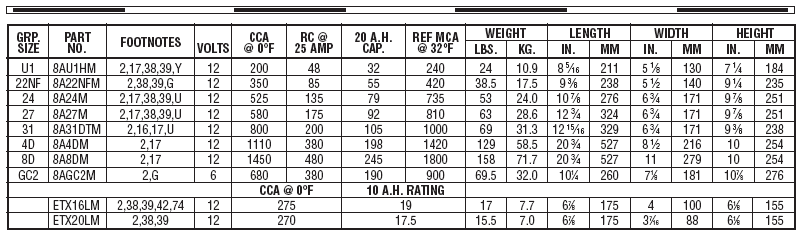

I would look at DEKA AGM GP 31 and replace my 27s with these. They are nearly exactly the same size but 6 lbs heavier. They will give you 105 Ahr vs 92 Ahrs for the 27. You can get these Deka batteries shipped anywhere for free from tristatebattery.com/

Here is screen capture of the key data, but see the PDF above for more.
Click image to blow this up...
