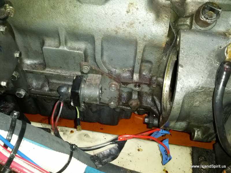

12 years 2 months ago #3371 by hayden
Replied by hayden on topic Re: Starter switch only works intermittenly
Marc:
Good job on adding the relay. The Island Packet Factory has been doing this for a while. As mentioned above, the wiring runs from the key switch to the starter is to small of a gauge and too long so the voltage drops and will not kick over the started. So adding this 12 volt relay solves the problem.
Here are two photos on the IP35 with a 3JH2e yanmar. Yanmar and IP added this relay under the starter.
The starter on the 3JH2e
The factory relay on the 1994 IP35
