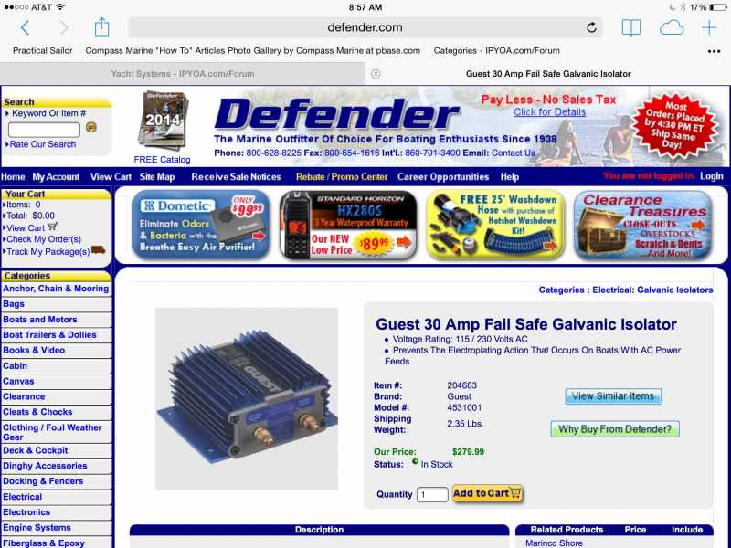

I have taken a different approach. I cleaned all the connections of ground and bonding green wires. Then last weekend I installed a fail safe galvanic isolator. I have been going through one prop zinc every five months, so I will be able to compare. Here is the isolator I chose. The install was easy.
